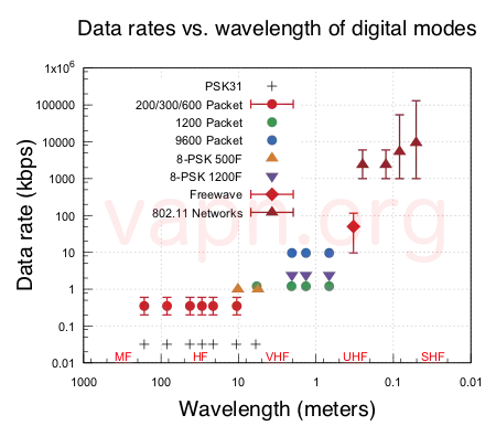

For what it's worth, I made a graph of a token selection of amateur digital modes with bandwidth vs. frequency (as wavelength) to provide a rough sense of the digital scene.
This came from our feasibility study for a new packet system in the Virginia area.

  • I can understand the correlation between bandwidth and transfer rate, but why you can send more data using a shorter wavelength? From the other answers I've gathered that: longer wavelength accounts for more resiliency to propagation conditions and that shorter wavelength accounts for less noise (highly directional), so is the less noise the prevailing factor here? Or are there others ones? – Redoman Aug 02 '16 at 15:24
    The prevailing factor for speed of data transmission is almost always going to be bandwidth and there is simply gobs more of that available at the higher frequencies... hence the correlation. Take 802.11 WiFi for example. Its signal is something like 22 MHz. wide... 3 can nicely fit shoulder to shoulder in the 2400 MHz ISM band without overlap. Try to do this in the HF band and you gobble up over 2/3 of that band. You can begin to see why commercial entities bid enormous sums for the rights to these short wavelength bands. – JSH Aug 02 '16 at 20:08
It really is a function of the bandwidth of the signal which is driven by the speed. Lower-speed, lower-bandwidth signals take up "less space" on the air and are on HF while higher-speed, wider signals are on VHF and higher.
Lower-speed modes also tend to be more resilient in the face of varying band conditions, as found on HF. VHF and higher tend to be more stable but much more local as well.
