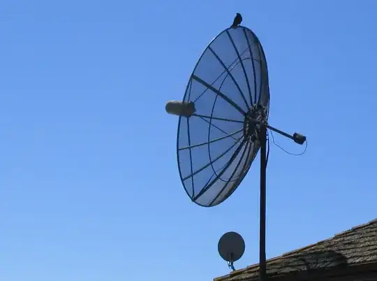

Below is a stock picture (Wikimedia) of an old 1980s style home satellite tv dish, about 8 to 15 feet across. That's what you want to play with, if you have the time, energy, and patience.
popular 1980s satellite receiving dish:  source WikiMedia
These were popular in the early 1980s to receive pay TV channels like HBO direct from the satellite, unencrypted, without paying. Once these channels were encrypted and consumers were asked to pay, the huge dishes started disappearing from homes and into the landfills.

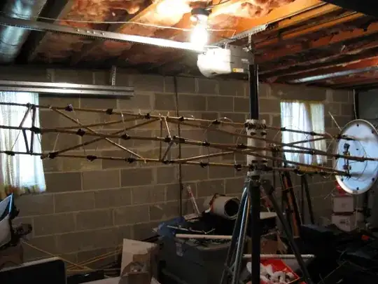

A bit more challenging is to create a 2m helix based on the satellite dish, with the dish as the rear reflector. This involves supporting a helix of wire above the dish, and admittedly it is a project. Each loop of the helix is about a wavelength worth of wire and the travel is a little less than a 1/4 wavelength per round trip around the helix. See Helical Antenna Theory or Wikipedia Helical Antenna.
I've made a 70cm helix antenna suitable for receiving low earth orbit ham radio satellites from bamboo and a Wal Mart Pizza Pan as the reflector.
Transmitting to the satellite is done on 2m with a more traditional antenna.
But with a large dish, and a way to point it, it becomes possible to make a 2m helix antenna, or perhaps make a dual band helix by making the spirals concentric.
