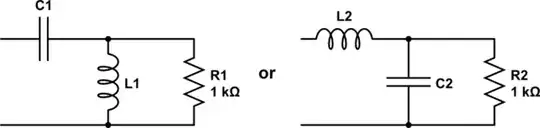

However, it is pretty safe to assume that in all cases, the feedpoint impedance is high, and we need some way to make it lower to match 50 ohms. If the impedance is already purely resistive, then a transformer with the right turns ratio will do the trick.
But we can also accomplish a step-down in impedance with either:
  • a parallel inductor + a series capacitor, or
  • a series inductor + a parallel capacitor.
schematic
simulate this circuit – Schematic created using CircuitLab

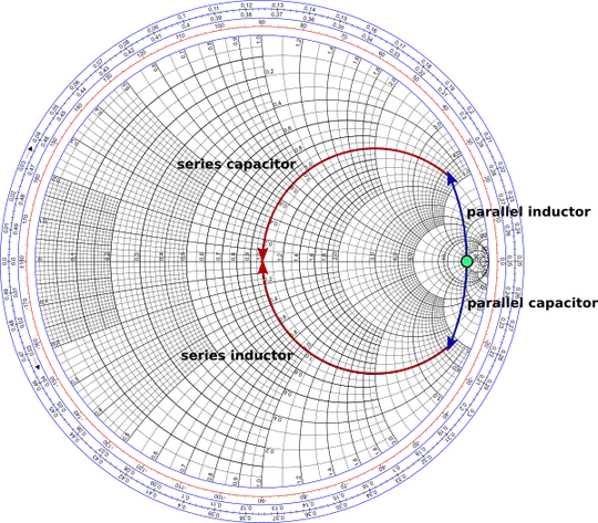

It's easy to see how this works on a Smith chart: if we start at 1000 ohms (the green dot) then there are two ways we can get to 50 ohms (the center):

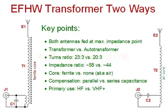

Your posting is a good reminder how prevalent end-fed half-wave (EFHW) dipoles are in the commercial antenna biz. The marine VHF antenna industry seems to be the most obvious of the bunch given the need for an antenna to function "well" without benefit of a conductive structure to mount upon.
My ham VHF/UHF mobile antenna is another EFHW example where measurements confirm improvement over its predecessor.

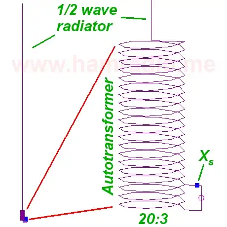

Looking into the various EFHW offerings reveals an exemplar matching transformer at the base that looks something like this...
The end-fed half-wave dipole antenna with magnified view of transformer.
More details available in this article. The above operates well, in simulation, without any need of the oft mentioned counterpoise, etc. Measurements of an HF analog to the above reinforce the ability of an EFHW to operate independent of additional conductors albeit with a bit of loss in the slightly different transformer structure.
Difference between EFHW transformer configurations
However, feedlines are the norm so I am exploring the effects there as well.

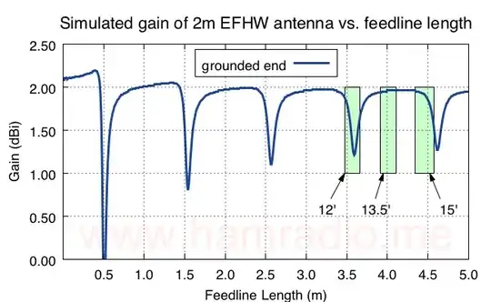

The following graph details the behavior of the VHF/UHF mobile EFHW above against varying lengths of feedline with a grounded end/radio. The frequency is 146 MHz.
The peculiar 13.5′ feedline length of the Diamond K515 mount.
Clearly there are certain lengths one should avoid lest we rob energy from the antenna, but the good news is most lengths seem to play well enough. One can only wonder if the unusually specific length of 13.5 feet was chosen by the maker of my mobile antenna to precisely avoid certain lengths that will entice current from the antenna down the feedline. More detail in the article. This assertion is pure conjecture on my part, but I do wonder if the stock feedline lengths of the marine VHF mobile antennas are also of some specific and peculiar length.
In summary, the longevity of the EFHW design in the world of radio, especially VHF marine, gives comfort the manufacturers know what they are doing and the notion feeding a half-wave dipole from the end = NBD.
