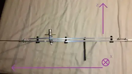

I've recently obtained a Quad Loop antenna for 2 m and 70 cm that's fed through gamma match, as shown in the picture:
Photo of gamma match section in YZ plane
The shorter metal bars are connected to the hot side of the BNC, while the longer assembly is connected to the ground of the BNC. Screws are made of dielectric material.

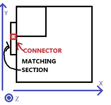

Here's drawing of the whole antenna. The connector and matching section is on top of the parallelogram part of the antenna and is on the left side.
Diagram of the antenna with matching section and connector shown in XY plane
Diagram of the antenna with matching section and connector shown in YZ plane
On these (not to scale!)diagrams, the BNC connector in in red, the antenna assembly that connects to the connector's ground side is in black, the assembly that connects to the connector's hot side is in orange, the screws are in brown. The orange and black parts are not directly connected, it's just that I don't know how to draw good 3D shapes.

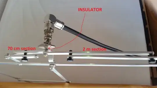

Photo of the connector:
Image of the center connector
There are 3 versions of the antenna that I have: 2 m version, 70 cm version and the dual-band version. The sections marked as 70 cm and 2 m on the image are the sections that appear on the mono-band versions of the antenna. They are connected to the center pin of the BNC connector. The big frame is connected to the ground of the BNC.

  • @Kevin Reid AG6YO♦ 1: I hope I made the design a bit more clear with the two new diagrams. The two black squares are connected to the ground of the BNC and the signal side if connected to the orange section on the second diagram. 2. I'm looking for any advice more in-depth than what you mentioned. I mean, for dipoles, we can take a number of SWR measurements and then determine if the antenna is more inductive or capacitive. Is there something similar for this setup? – AndrejaKo Oct 01 '15 at 22:38

  • I'm having a hard time figuring out what's going on right around the connector. Some close-up, off-axis photons of that area would help. Also, does "HF" mean something other than the band between 3 and 30 MHz in German? The rest of the manual suggests this is a VHF antenna, so it's odd they would write "The window pane offers the best HF position!" – Phil Frost - W8II Jun 15 '17 at 13:39
  • @Phil Frost - W8II I tired to do my best, but it's really hard to take good photos of this antenna, because of its shape. In my opinion, the "HF" was used not in the strict sense, but in a more generalized sense, more like RF would be used in English. For example, at my university in Germany, the HF-technology department did microwave stuff. – AndrejaKo Jun 15 '17 at 14:46
  • That picture helps a lot! I'll have to think about how this might work before answering; it's certainly a non-trivial design. – Phil Frost - W8II Jun 15 '17 at 14:54
  • @Phil Frost - W8II Yeah, it is a bit complicated. Also, on some of the pictures and diagrams, the matching section is on the internal side of the antenna, and on other pictures and diagrams, it's on the external side of the antenna. I did try both ways and have pretty much equally bad results in both situations. – AndrejaKo Jun 15 '17 at 14:58
Well, I'm a little out of my depth, but this does seem to have all the usual parts of a gamma match: the matching section hanging off the main loop is a balanced transmission line, and the part connected to the BNC center is spaced off it, so the coax is coupled capacitively into that transmission line.
There are two transmission lines, and two gamma matches, one to the left and one to the right, I'm guessing one for each band. Getting a match on both bands will probably require adjustment in little steps with frequent checks on each band since the tuning for one band will have some effect on the other.
There's some information on how gamma matches work generally: What is a Gamma match in the context of the driven element of a Yagi antenna?
It appears the only adjustable thing here is the spacing of the capacitor. Most pictures of gamma matches use some arrangement with tubing to make a coaxial capacitor which slides for adjustment, but I don't see why this design wouldn't work the same way. Turning the screws to bring the pieces closer together increases the capacitance. That will move the feedpoint impedance along the path of the final arrow on this Smith chart: closer spacing -> higher capacitance -> longer arrow.
So, the idea would be if the feedpoint impedance is inductive, then turn the screws to bring the plates closer together. If it's capacitive, move them apart. You should be able to cancel out any reactance in the impedance. And if everything is right, you'll end up around 50Ω.
