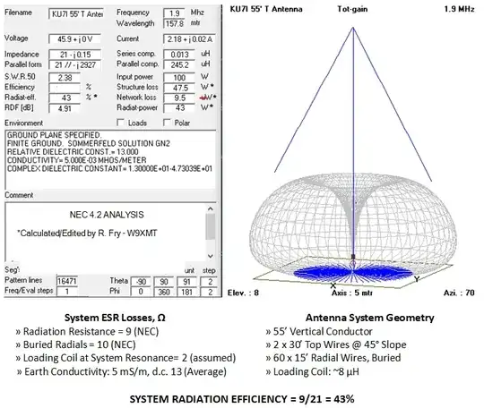

The radiation efficiency of all antenna systems is the quotient of its radiation resistance and the sum of the real (energy-dissipating) resistive losses comprising that system.
Some M-o-M software using NEC (Numerical Electromagnetics Code) reports values identified/expected to be radiation efficiency, but including the effects of propagation loss in those values.
Below is an example of a customized study where the radiation efficiency excludes propagation losses.
