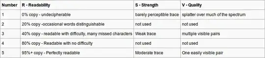

On digital modes (particularly PSK31) RSQ (Readability, Strength, and Quality) is usually used for signal reports, instead of RST (Readability, Strength, CW Tone). There is some interesting history and background information on the RSQ system available at psb-info.net a site dedicated to the RSQ signal report.
R = RSQ Readability (Percent characters correctly received):
  • R 1 – 0% Undecipherable
  • R 2 – 20% Occasional words distinguishable
  • R 3 – 40% Considerable difficulty, many missed characters
  • R 4 – 80% Practically no difficulty, occasional missed characters
  • R 5 – 95%+ Perfectly readable
S = RSQ Strength (Signal over Noise rather than S-Meter):
  • S 1 – Barely perceptible trace
  • S 3 – Weak trace
  • S 5 – Moderate trace
  • S 7 – Strong trace
  • S 9 – Very Strong trace
Q = RSQ Quality:
  • Q 1 – Splatter over much of the spectrum
  • Q 3 – Multiple visible pairs
  • Q 5 – One easily visible pair
  • Q 7 – One barely visible pair
  • Q 9 – Clean signal – no visible unwanted sidebar pairs
Here is a minified table version I found:
