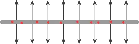

So consider that we have a short section of coax. At this very instant, there is an excess of electrons on the shield:
and an excess of electron holes on the center conductor:
I've drawn electrons as blue, and electron holes as red. And the arrows represent the electric field. If you were a positive electric charge floating about, the arrows point in the direction you'd feel a push. You'd be attracted to the shield, because positive charges are attracted to the negative charge of electrons. And likewise, you are repelled from the center conductor.
As you get farther away, the push you feel becomes less, but it never fully goes away. These fields extend to infinity, so if we can make these electric fields oscillate, we'd probably have a good antenna.

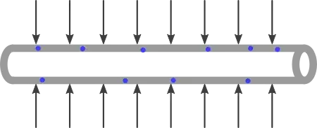

However, there are exactly as many electrons as there are electron holes in this diagram. Consequently, the fields are equal in magnitude: they are just opposite in direction. So if you put the two together:
Now the electric field exists only inside the coax. A floating positive charge outside the coax simultaneously feels a push and a pull that are equal. That is, it doesn't feel anything at all. The field does not extend to infinity: the coax does not radiate (or receive, by reciprocity).

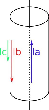

Let's say I divide all the currents on some coax into three components:
  • $I_a$ is the current on the center conductor.
  • $I_b$ is the portion of current on the shield which is equal and opposite $I_a$. These are the differential-mode currents.
  • $I_c$ is whatever current is left over: the common-mode current. It can be of any direction or magnitude, independently of $I_a$ and $I_b$.
Notice that $I_c$, the common-mode current, is on the outside of the shield. There's no provision for a common-mode current on the center conductor, because it can't happen (for RF currents, anyway).
The reason is skin effect. Normally we talk about skin effect as causing the RF current to flow on or near the outer surface of a solid conductor. However, the electric and magnetic fields responsible for skin effect can reach across the dielectric of the coax as well: any common-mode current on the center conductor will create eddy currents that cancel the center conductor's current, replacing it with a current on the shield.
Also, notice that $I_b$, the shield's half of the differential-mode current, is drawn on the inside of the shield. That's because the charges associated with this current are attracted to the opposite charges associated with the current on the center conductor.
