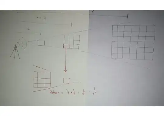

In addition to Phil Frost's answer. I believe what's missing is a coefficient sigma, which represents the amount of signal returned to the transceiver. Let's assume some units (m and m-squared if you like). Pictured below is a signal that at 1 unit from transmitter, is spread over 1 unit squared of area. At 3 units from the transmitter, covers 9 units squared of area. This is the basic inverse square law. (the intensity is spread over this area - hence the inverse part).
Now let's assume sigma is 1 unit square (the amount of signal returned - not necessarily equivalent to surface area of the target as it is also shape dependent - see Phil Frost's answer). The red illustrates a simple application of the same inverse square law and shows that the signal picked up at the point of transmission again will be proportional to 1/r^4.
The mistake I made in my original post was assuming that the entire signal is reflected. This was implicit in assuming that the return signal is equivalent to simply extending the signal over the same distance again. This would only be the case if sigma was proportional to r-squared. So if, at r = 3, sigma was 9 units square, then it would be equivalent to continuing the original signal over double the distance. (sigma sits on the top the intensity equation, so it it's proportional to r^2, the remaining r in the denominator is r^2).
To put it another way, if only a single unit square is returned, this unit square is projected onto 9 units square back at r=1 (shown in red). So the intensity is spread of 9 units square of area. If the signal continues to r=5 (same extra distance covered) that single unit square projects onto less than 9 units squared (9 units squared needs to project onto 25, so each can only project onto 25/9 units squared) so the signal here is more intense. (as expected - proportional to 1/r^2 not 1/r^4.
radar return
Hope that makes some sense, anyone have any corrections?
Matt
  • 81
  • Did you mean, "At 3 units from the transmitter, covers *9* units squared of area." – Phil Frost - W8II Mar 09 '16 at 22:38
  • "The mistake I made in my original post was assuming that the entire signal is reflected." I'm not sure if that's all of the mistake, or at least, if that phrasing entirely captures it. It's not just how much of the signal is reflected, but *how* it's reflected. Think of a laser pointer hitting a mirror, versus a white sheet of paper. In each case, the entire signal is reflected, but the power received back at the laser pointer is very different. – Phil Frost - W8II Mar 09 '16 at 22:44
  • It's also the case that if you could focus the radar beam so tightly that all the radar's energy hit the target (ignoring for the moment that it would be impossible), then the energy received will still be $\propto 1/r^4$. – Phil Frost - W8II Mar 09 '16 at 22:45
  • Yes I meant 9,fixed that. I agree with your second point, I don't know if sigma accounts for that or if another variable accounts for the reflective nature of the material. For your third point, I'm not sure I follow. Wouldn't the at the target have lost no energy in that case, and only dissipate on the return, so 1/r²? – Matt Mar 11 '16 at 06:04
  • "Wouldn't the at the target have lost no energy in that case" Yes, I concede you are right there. But also consider, this would mean the transmitter would need to focus the beam to an increasingly narrow beam as the target moves away, which is equivalent to increasing the antenna gain, so it's not an entirely apples-to-apples comparison. – Phil Frost - W8II Mar 11 '16 at 15:02
