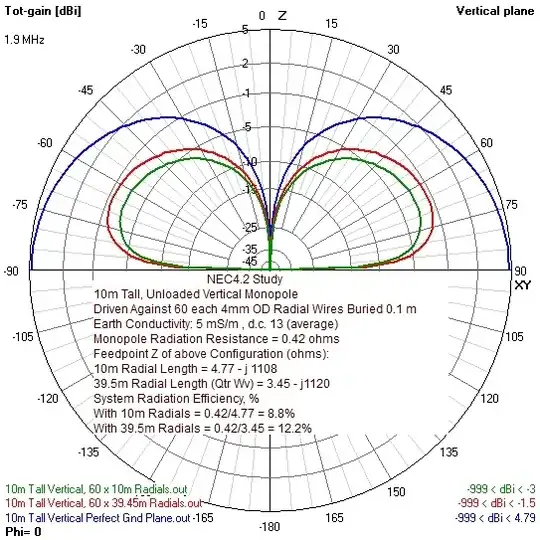

For an example using 4nec2 with a NEC4.2 engine, the far-field study shown below illustrates that the E/E(max) relative fields of a vertical monopole remain the same for the two different configurations of a lossy ground plane connection to the earth, but not their gains (efficiencies).
The blue trace there shows the pattern directivity if that system had zero losses, and in this configuration, antenna system radiation efficiency is 100%.
