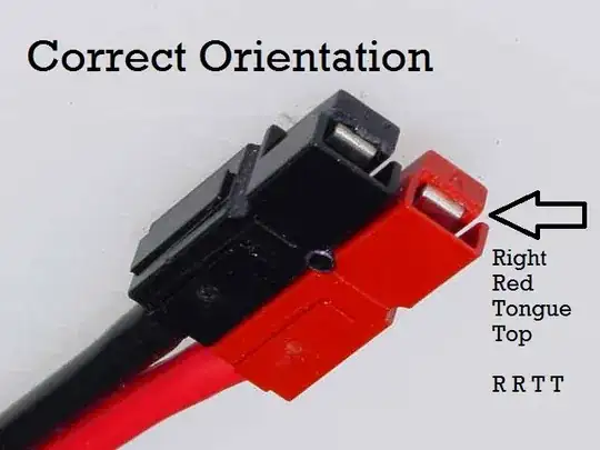

From http://rallynotes.com/2017/03/12v-anderson-powerpoles/:
correct orientation
This is a good image for orientation reference.

They say a picture is worth a thousand words:
Powerpole connector
Source: ARRL
If viewed from the "hood" side where the connector is flat, with the wires going down, and the mating side of the connector up, then the positive side is on the right.
Other amateur radio sources that corroborate this orientation:
Beware: this is a recommendation, not a standard. Hopefully within amateur radio people observe the ARRL recommendation, but Powerpole connectors are made of individual pieces which can be stacked in any orientation. If you do an image search you can find examples where people have assembled them the other way. There's significant potential for an expensive mistake here.

The mnemonic that I use is "red right tongue top". (It leaves out "when the connectors are pointed at you.") That is to say, when the tongues are up, then the red connector is on the right.
