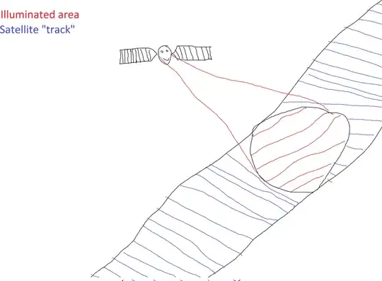

The type of RADARs used there is a so-called synthetic aperture radar. That means that the satellite will have a high-gain antenna pointed at a relatively small area on the ground that will be "scanned" by the RADAR. The satellite will then make a number of successive overflies over the area, each time "shaving" a strip of ground it scanned. The result of that is that the area that is under interference at one time moment will be relatively small and the interference will not last long, since the satellite keeps moving.
Illustration of SAR principle
So in the picture here, the blue stripes are the "track" the satellite is covering on the ground and the red area is covered by the satellite at any one moment. Afterwards, the data is merged into a single image. When the track is passed, the satellite will, in the next orbit, shift it a bit to the side and repeat the procedure for the next track.
