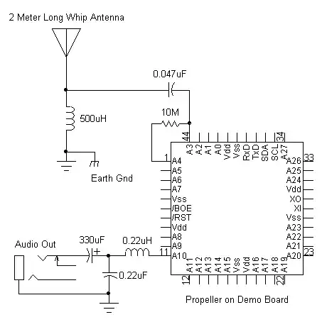

*APPLICATION The use of a Propeller counter as the basis for an analog-to-digital converter (ADC) is now well-established. So why not simply attach an antenna to the input of one of these ADCs and see what comes out? Basically, that's what I've done. Here's a schematic:
schematic
The antenna (a wire strung across the ceiling of my shop) is connected, through an inductor to both digital ground and earth ground. I used a 330uH power inductor I found in my junkbox. It actually worked better than the ferrite antenna scavenged from a cheap transistor radio. A bunch of enameled wire wound on a plastic sewing machine bobbin worked almost as well, too. I'm sure Beau Schwabe (i.e "He Who Understands Inductors and Knows What to Do with Them") can shed a lot more light on the choice of inductors and why one is needed here. I just grabbed what I had until I found something that worked. My "earth ground" consists of the ground clip from my scope attached to the ground stud on the Demo Board. My scope input return ground and its AC protective ground are connected together, thence back to the breaker box and to a metal grounding rod. (By the way, I live in a fringe area for AM reception. If you live in a city with strong AM transmitters, you may not have to go to all this trouble.)
The antenna also connects, through a capacitor, to pin A3 of the Propeller. This is the "analog" input terminal. The feedback comes from A4 through a 470K 0805 SMD resistor, which I soldered between pins A3 and A4 right on the chip itself. I've omitted the usual filter caps to Vdd and Vss (Gnd), choosing instead to let the inherent input capacitance of A3 do the filtering. This keeps both the input impedance and frequency response of the ADC high, which is necessary for detecting weak RF signals. During positive swings of an incoming signal, A4 will be sending more 0s than 1s to counterbalance it; during negative swings, more 1s than 0s. One counter can do this, set up in the "positive-with-feedback" special analog mode. Unlike the usual ADC usage, though, we're never going to read this counter again. It's just that string of 1s and 0s fed back from A4 that we're interested in. I love the Propeller's counters! I don't know if Chip knew what all could be done with them when he designed them, or if he just had an inkling that, with the right set of features, almost anything could be accomplished. In any event, the counters make ideal local oscillators and mixers! The oscillator part is pretty easy: just configure two counters as numerically-controlled oscillators (NCOs) in quadrature with each other. The frequency will be the frequency of the station you want to tune in. So, if I want to receive KIXI 880 in Seattle, I set up both counters to output 880KHz square waves, 90° out of phase with each other (i.e. PHSB = PHSA + $4000_0000).

Update: Owing to advice received from Beau Schwabe, based on his own testing, I've changed some component values. The inductor is now 500uH; the feedback resistor, 10M; the coupling cap, 0.047uF; and the antenna, a 2-meter-long vertical wire. The attached schematic reflects these changes, which did lead to an improvement in performance.*

  • The front end circuit http://mstram.alwaysdata.net/PropellerRadio.gif (couldn't add to original post because of "rep" points :\ – mstram May 11 '16 at 01:26

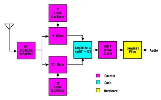

Very interesting (and clever)!
block diagram
Yes, the first counter is being used as a delta-sigma modulator to turn the incoming analog signal into a high-speed string of bits. Then the counters generating the I and Q signals are defining the lower-speed sample rate. Two other counters (labeled "mixer") are essentially integrating (i.e., low-pass filtering) the high-speed sample data for each output sample period.
If the high-speed sample rate is 80 MHz, and the carrier frequency is on the order of 1 MHz, the output samples are counts in the range of 0 to 79, roughly 6 bits of resolution.
Since the sample rate of the output is equal to the carrier frequency, this creates a direct-conversion receiver. The sample clock serves the same function as the local oscillator in an analog receiver. In digital terms, the carrier, along with its sidebands, is being deliberately aliased down to DC, which means that the sidebands become the audio that you can hear. The low-pass filtering of the output (partly in the integrators, and partly in the analog output connection) determines the bandwidth that is being received.
