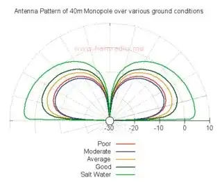

A typical gain pattern for a quarter wave ground plane antenna is:
Image from a similar question and see watermark.

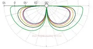

A naive response would be that the antenna's pattern would be unaffected except to be rotated 180 degrees, i.e.:
An answer to a similar question seems to imply that the radials on a ground plane antenna don't have as much to do with the pattern as the actual earth. My trials at modeling this with EZNEC resulted in no change based on the antenna's orientation, but I don't trust myself.
Also, looking at just the plots would lead you to believe that there is zero chance of receiving a signal from below the antenna's elevations. Which also is hard to believe.

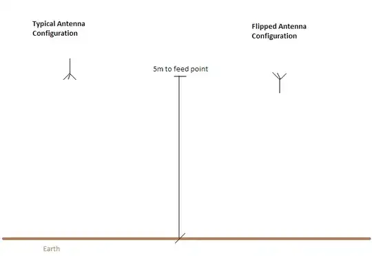

Simplified configuration for clarity:

    well, how "high" would you "hang" your antenna? if you just mirror your pattern, you'll notice that everything would be reflected/swallowed by the ground, as it geometrically is directed "downwards"... I'm not quite sure I correctly understand your question. Could you make a short drawing of what you have in mind? – Marcus Müller Jun 20 '16 at 10:22
  • @MarcusMüller I added a height to the question (5m), but that is kind of the point. Does the diagram flip so that everything is upside down? The only thing that changes about the antenna is that the radials are on the top and the vertical is on the bottom. The whole antenna is rotated to point down. – hazzey Jun 20 '16 at 13:25
    I asked for a drawing for a reason :) Now, the diagram **cannot** flip, because then the main lobes would point down, but there's mother earth in the way. If you make a drawing, you'll notice that problem. – Marcus Müller Jun 20 '16 at 14:23
  • @MarcusMüller Added the diagram as requested. If you are saying that plot cannot be flipped because the earth has more to do with the gain plot than the location of the radials, then that sounds like an answer. – hazzey Jun 20 '16 at 16:12

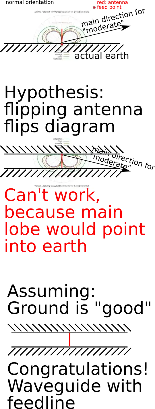

To answer this very graphically:
Flipping the diagram geometrically can't work:
Diagrams
What you've actually build is kind of a waveguide, consisting of two grounded planes below (earth) and above (virtual earth spanned by radials) your antenna; in this rotation-symmetrical setup, the H-field only exists in horizontal direction, and the E-field between the two planes will only exist vertically.
In other words: if we assume the virtual ground plane to be a perfect circle, then this looks like a lot of dipoles standing tightly next to each other between that plane's edge and the ground, being fed with exactly the same signal. Since this, for symmetry reasons, won't have any horizontal gain, the only gain we can have is vertical; but there's no vertical group factor in a group of horizontally shifted dipoles, so this will really just have the radiation pattern of a half-length dipole.

  • Leave it to you, @Marcus, to come up with this one. You crack me up. The two grounds would be loosely coupled, of course, but still. – SDsolar May 12 '17 at 23:56
    @SDsolar yeah, and, admittedly, the "very large hovering ground plane" would be something strictly out of a scify book, but still :) – Marcus Müller May 13 '17 at 08:14
  • Of course, if Earth were surrounded by at atmospheric layer that contained mobile ions, the situation in the final illustration may not be so completely unrealistic. We might even hypothesize the feasibility of global communication under the right conditions... – Phil Frost - W8II Feb 24 '19 at 14:33
  • @PhilFrost-W8II woah! How sci-fi would that be?! :D – Marcus Müller Feb 24 '19 at 14:56
