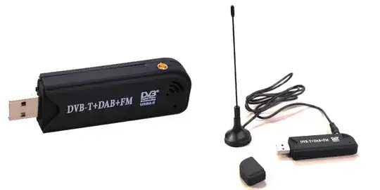

I have a CB radio and I occasionally mess with a cheap SDR Dongle I have. I can pick up CB transmissions no problem but would like to be able to broadcast from my SDR. Is there any way to do this? I believe that it is a RTL-SDR I have never really been able to figure it out.
If the radio is not compatible do you have any recommendations of one that is?
1ntel0pe
An RTL Dongle is Receive-Only. You can't transmit with it.
