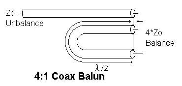

The best results I have established over the years is to use a 4:1 balun, which then needs to be fed "higher" on the matching section to get a 200 Ohm match, combined with a good number of beeds on the coax.
You can easily create 4:1 match using something like this:
4:1
This will at least transform your unbalanced 50 Ohm feed into 200 Ohm balanced, for the balanced matching section of the J-pole. It still is a unbalanced half-wave radiator, nothing you really can do about that.
Personally I have given up on J-poles, while with the above method I had some success, I really think that a standard quarter-wave GP, or a vertical half-wave dipole is much easier and I had better results.
