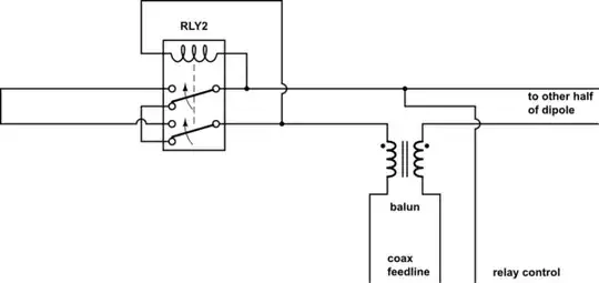

I've never done this, and I can't find descriptions by anyone who has, but I might try using twin-lead as the antenna element. The common-mode current radiates as a dipole normally would, while you can use the differential mode to control a DPDT relay.
The trouble then is the mechanism to control both common and differential modes from the shack. You don't want to put common-mode RF on the feedline: that would make it an antenna. If only you had a 3rd wire...
If you use a folded dipole, you can make one. At the center of what would normally be the undriven element is "ground". You can just attach a wire there. And if "ground" is actually DC +12V, you can use that to control the relay coils.
schematic
simulate this circuit – Schematic created using CircuitLab
Of course you'll need to impedance match the folded dipole somehow, like a 4:1 balun.
You could also avoid running the 3rd wire to the shack if instead you use a DC bias on the coax and separate that from the RF at the feedpoint with a capacitor.

  • The voltages would be higher if there were any sort of SWR mismatch, right? So it seems to me that the relays should be designed for an even higher voltage, in case the operator accidentally transmits on a band other than the one the antenna is set for. – rclocher3 Sep 12 '16 at 15:35
  • @rclocher3 To the extent that you have an amplifier that can transmit more than it's rated power into a mismatch, I suppose so. I think the thing to do is determine the peak power the transmitter can generate under any circumstances, and design for that. – Phil Frost - W8II Sep 12 '16 at 15:46
  • I know most modern transmitters "fold back" when they discover an SWR mismatch, but I wonder if the relays would have time to arc over before the SWR measurement circuit discovers the mismatch. – rclocher3 Sep 12 '16 at 15:51
  • Sounds like a valid concern. I wonder if you might get by with some [TVS diodes in series](http://www.vishay.com/docs/88451/stacking.pdf). I'm also not entirely sure how to calculate the peak voltage when the dipole is not self-resonant. Intuition tells me it might be lower for the same power, but I'm not sure. – Phil Frost - W8II Sep 12 '16 at 16:04
