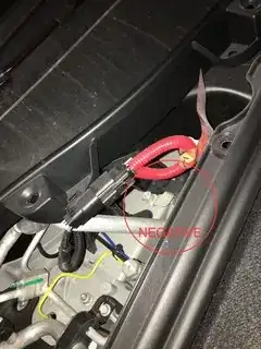

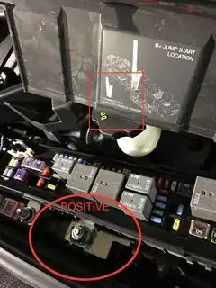

Taking a look under the hood, so to speak, this is precisely the situation in my car … except not for a cigarette-lighter port, rather literally for the entire car — of the 50A primary-12V “battery terminals” you're supposed to jump her with, the negative is simply a post on the chassis:
positive terminal and instructions negative terminal

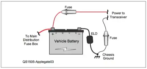

Allow me to refer you to Alan Applegate K0BG's excellent page about mobile radio wiring and grounding. That page recommends that you power the radio with a fused negative lead connected to the chassis, and a fused positive lead connected to the main battery. Here's a picture:
how to wire a mobile radio
Alan's site is chock-full of excellent advice about seemingly every aspect of mobile operating.
Regarding your specific question, I'd of course recommend that you don't use the cigarette lighter to power your radio, but you knew that already. There's nothing stopping you from using the same chassis ground point as the ELD (electronic load detector) in the picture for your fused negative lead. That way you won't have the steel chassis in your current path.
