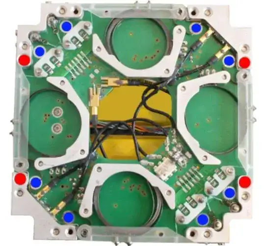

My cubesat team is working on our design for rolled whip antennas to deploy in a UHF turnstile configuration based on this design: enter image description here
What I would like advice on is the material for the antennas themselves. Spring steel has ideal mechanical properties, but isn't an optimal antenna metal. The material of the one shown is apparently Nitinol shape memory alloy, that will unroll itself when heated. What other metals would you suggest looking into further?

    Can you tell us more about your reference design? I don't fully understand it; to me, it looks like there's the PCB and potentially critical components with very varying magnetic susceptibility where the magnetic field of the coils would be strongest o.O – Marcus Müller Oct 17 '16 at 09:25
  • Ahhh I'm stupid; this is a *rolled up antenna*, prior to being deployed in space :) – Marcus Müller Oct 17 '16 at 09:30
As usual, for antennas, the better your material conducts, the higher your antenna efficiency. Hence, go for copper. It has an excellent conductivity per volume (which might or might not be critical in your application), and there's not many metals that will beat its conductivity at all. Steel really isn't good for that.
If you're using suitable frequencies, steel wire with a copper coating might work for a dipole. The frequency will define your skin depth and the losses that a non-perfectly conducting antenna will incur. Definitely sounds like you'd have to just copper-coat some spring steel and try.
Another thing: I don't know how stiff the deployed antenna will be, but you are in the earth's magnetic field, with long ferromagnetic rods; that will excert a torque on your satellite... I can't calculate how much, though, since I know nothing about your antenna sizes, your orbit, your height or anything about the satellite.

I think the mechanical properties for proper deployment are much more important than the electrical properties.
The picture appears to show elements that are flat tapes rather than round wires, which is probably a good idea. I'm thinking that if the tape can be given a slightly U-shaped cross-section (like a steel measuring tape), it will be better able to fully straighten itself after deployment, and may allow you to use thinner (lighter) steel stock.
And as Marcus says, plating the steel with copper and/or silver will improve its electrical characteristics without compromising its mechanical characteristics.
I'm trying to figure out the deployment mechanism, but the picture is a bit fuzzy. There are little plastic doors holding the coiled elements in place, with spring-loaded threads holding the doors closed. Are those pairs of SMD resistors designed to heat up and cut the thread for deployment?
Dave Tweed N3AOA
  • 1,210
  • The system has coiled antenna elements that load the doors, which are held in place with monofilament. When you heat the resistors, the monofilament plasticly deforms and the antenna springs out. – Kontakt Oct 17 '16 at 13:36
  • Ah. So you're sure that the monofilament will never reach its "plastic deformation" temperature at any time during the pre-launch or launch procedures, and that the resistors CAN heat it up to that temperature under all ambient conditions after the cubesat has separated from the launch vehicle... – Dave Tweed N3AOA Oct 17 '16 at 13:49
  • Yes. It's a proven design and the standard for cubesat deployments. – Kontakt Oct 17 '16 at 13:50
  • OK, but then what is your actual question? Are you proposing to deviate from the standard in some way? Surely the material from which the elements are made is part of that standard. – Dave Tweed N3AOA Oct 17 '16 at 13:51
  • It seems to me that the only "degree of freedom" that you have here is selecting the deployed length of each element. – Dave Tweed N3AOA Oct 17 '16 at 14:00
  • Antenna material is highly variable. If you google "cubesat antenna" you'll see a huge variance in layout, material and antenna type. Many satellites use tape measure cut to length and apparently the material shown in the picture is nitinol shape-memory alloy which is a titanium/nickel alloy. Thermal cutters are just the most well known and tested method for deploying things on cubesats. – Kontakt Oct 17 '16 at 14:05
  • All of which serves to reinforce my point that the mechanical requirements for the chosen material far outweigh the electrical requirements. – Dave Tweed N3AOA Oct 17 '16 at 14:10
  • They are important, but I'm not going to commit to a marginal electrical solution in favor of a maximized mechanical concept without at least considering a better solution. The mechanical system isn't that complex, it's just the worst failure mode. This question was already helpful to my by the suggestion of copper plating, which we will evaluate. – Kontakt Oct 17 '16 at 14:13
