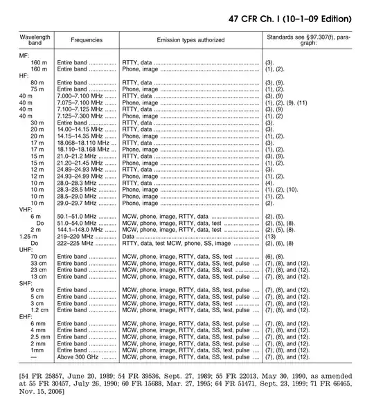

This is indeed in the FCC regulations. In Part 97, section 305 regarding "Authorized Emission Types" there is the following chart which lists two relevant subbands, see in the VHF group the 6m row and the Do ditto right below it:
FCC table showing authorized emission types by frequency range
Tracing our way outwards from there, we find:
  • 47 CFR §97.305(c) is the heart of the FCC regulation on which the ARRL legend note is based.
  • Limited testing is permitted on all amateur-allocated frequencies, and experimental digital modes are also cautiously permitted within the HF bands (i.e. below the frequency in question). In the HF bands, there are a number of technical and discretionary restrictions that can apply to data emissions.
  • At 51 MHz and above there is basically no technical restriction on emission types within the amateur allocations. Advance the radio art! (You still can't "obscure your meaning" or avoid good amateur practice, of course.)
  • Yes, 51.0 MHz is really the cutoff. (There's actually a specific bandwidth restriction that "hangs on" up through the 2m band, but the ARRL chart's summary is accurate enough.)
These answers are explored in more detail below.
Let's zero in on the difference between 50.1–51.0 MHz range vs. the 51.0-54.0 MHz range.* The first frequencies allow emissions of type "MCW, phone, image, RTTY, data" whereas the second allow all that and "…, test". This must be exactly what the ARRL chart is referring to. So yes, 51 MHz is the correct boundary for where "test" emissions may occur.
What is a "test" emission type? The definitions section of Part 97 says this:
Test. Emissions containing no information having the designators with N as the third symbol. Test does not include pulse emissions with no information or modulation unless pulse emissions are also authorized in the frequency band
But to expand on that a bit, the table above also has a "standards" column which lists only (2), (5) for the 50.1–51 MHz subband, but (2), (5), (8) for the 51.0–54.0 MHz portion [see updates below — this column is a red herring re. "test" emissions]. The definitions of these standards are given in § 97.301(f) within numbered paragraphs.

For the standard which seems to apply to "test" signals, we findThere's additional data privileges that start here too:
(8) A RTTY or data emission having designators with A, B, C, D, E, F, G, H, J or R as the first symbol; 1, 2, 7, 9 or X as the second symbol; and D or W as the third symbol is also authorized.
To understand this paragraph we actually have to jump out of Part 97 and in to Part 2 of the FCC's 47 CFR to learn their definitions of "Emission, modulation and transmission characteristics". If you do so, you'll find that there's not much that all those letters and numbers leave out. (For the life of me I can't figure out what the "E" modulation type is, but the others cover AM/SSB/FM/PM for any sort of baseband signal for any sort information….)
Note that this paragraph (8) standard is much broader definition than the overall "test" definition above, in that the third symbol is pretty much a wildcard, rather than the "no information" N symbol that test emissions in general are restricted to.
UPDATE: thanks to WA9ZZZ's answer I know think it's clear that the paragraph (8) standard has nothing to do with the "test" emissions also allowed starting at 51 MHz. (Case in point: note how the 23 cm and 13 cm band rows in the table have the same three Standards listed in that column, but one has "pulse" and the other doesn't in the "Emission types" column! Those columns aren't tied as closely as I originally assumed.)
