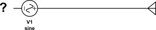

You are looking for a theoretical formulation. Consider, the feedpoint is a voltage source which makes a difference in electric potential between to things. The end of the dipole, and...what?
schematic
simulate this circuit – Schematic created using CircuitLab
Maybe you could imagine the feedpoint connected to a theoretical shell of infinite radius, similar to how self-capacitance is calculated? I'd guess the result depends strongly on the geometry of the wire, but generally the thicker the wire, the lower the impedance. I don't know of what practical value this model would be since any real antenna has at least a feedline and a ground/aircraft/spacetraft nearby which would be more significant.

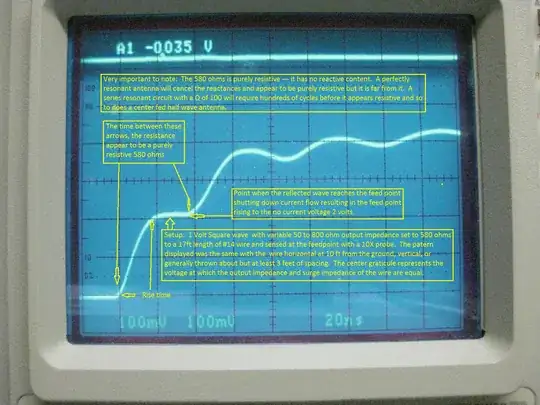

The following url represents a circuit that can be used to measure the surge impedance and velocity factor of a single wire or transmission line. It is a variable voltage divider, adjustable from 50 to 1050 ohms.
http://www.k9axn.com/attachments/Finished_3_jpg_final.jpg
The following url represents the measurement of the surge impedance and velocity factor of a 54 foot length of #14 wire.
http://k9axn.com/attachments/Single_wire_4.AVI
Important to note: The two timing lines from the rise to 115ns represent an approximately 4 volt @ .007A wave entering the wire. The wave will have reached the end of the wire at mid point, then return during the second half where you see the voltage rise to 8 volts and current cease.
The rise and fall times are a result of instrument limitations. Surge current behaves as purely resistive, much like the impedance of space. It is used to calculate the radiation resistance of an antenna and is largely unaffected by proximity to the ground.
END OF INFORMATION ADDED FOR CLARITY
The above Image represents the measurement of the Surge impedance and velocity factor of a single wire. It can be used to measure the Surge impedance and velocity factor in coax, twin lead or any antenna wire.
The surge impedance of a single conductor or transmission line is essentially composed of two primary notions, the impedance of space 377 ohms and the energy used to accelerate electrons. Be mindful that the electrons in a 1 KW 14MHz transmission line or antenna will remain within approximately 1/10,000 of an inch from where they started. This can be visualized using a Newton's cradle.
With that information it becomes clear that the opinions regarding end fed antennas are wanting: The impedance at the feed point is not infinite and is easily calculated. The reflected waves/current that flow within an antenna when reaching an end are wholly reflected.
The next edit will consist of a cycle by cycle narrative of the measurements and events as the antenna is spooled up.

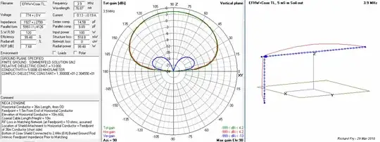

Below is a more elaborate analysis of an EFHW, with a length of vertical coaxial cable attached at its feedpoint. It includes the effects of radiation from the "unchoked" r-f current that could flow along the outer surface of the outer conductor of the coaxial cable.
Other details are shown in the Comment block at the lower left section of the graphic.

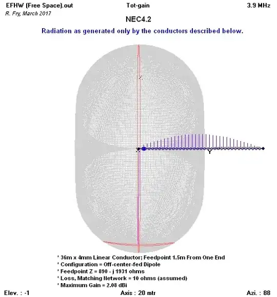

Below is a graphic showing the free space radiation pattern envelope and input Z of an end-fed, 1/2-wave (EFHW) antenna, for the other conditions shown there.
The radiation pattern maximum field is centered on the physical center of the antenna, but the pattern in this graphic was shifted to the left so as better to show the nulls off the ends of the antenna.
NOTE: Antennas and transmitters both are two-terminal devices, and will supply/radiate almost no energy if only one of their terminals is connected. The short, so-called counterpoise conductor of an "end-fed" antenna in reality means that this configuration is an off-center-fed dipole, as stated in the graphic.

  • Great simulation. You are correctly showing that the impedance of an off-centre fed dipole tends to infinity as the feedpoint moves to the end. Although the OP didn't draw it, I suggest that the end fed halfwave antenna is really a half wave of wire, feedpoint, and then a long piece of wire (the coax), all collinear. Can you add a simulation of that and show Z over frequency? – tomnexus Dec 19 '17 at 04:54
