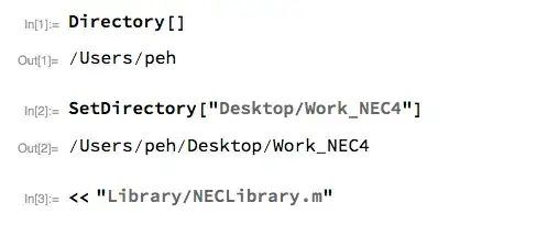

I first set up my Mathematica notebook environment as shown below:
Notebook Setup
The statements above establish my working directory for NEC4 work and then I import my Mathematica function library supporting the NEC4 work. By the way, this is all done with an Apple iMac-24 running OS X El Capitan.

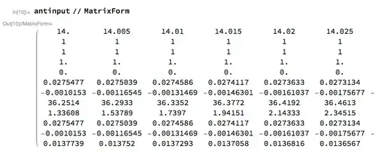

Next, I read in the antenna input solution data. This is the data that specifies the feed point voltage (R/X), feed point current (R/X), and feed point Impedance (R/X), feed point Admittance (R/X), and Power in Watts (R) for each frequency of the specified frequency sweep (given by the data file governing the solution). The integer values 1,1,1,0 in each column are the wire tag number, segment number, and the voltage (R/X) which is reported as integers 1 and 0 for the complex value 1.0+j0.0
Here are the Mathematica statements that read in the antenna input: antenna input
As you can see, I use a function that I wrote called readAntennaInput[] which is given the file name of the file with this data that was scraped by one of my Python programs from the NEC4 output data.
The array returned, given the Mathematica label of antinput is 12 rows by 71 columns. Each column is a different frequency for the frequency sweep.
Here is a portion of that data: enter image description here
You can see the individual frequency columns as row one designates the frequency beginning with 14.0 MHz and incrementing by 0.005 MHz until the maximum frequency of the sweep 14.35 MHz (the entire 20 meter band). The floating point numbers you see in each column are the R and X values of the parameters mentioned above. The two rows that have whole numbers are the R and X of the antenna feed point impedance.

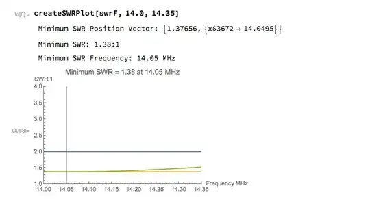

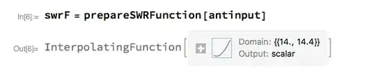

Next I prepare the SWR function. This is an interpolated function that computes the SWR based on a nominal value of 50.0 ohms Real. Thus, SWR of 1:1 would suggest 50 ohms input impedance for the antenna.
The function that I wrote to compute this SWR Function is called prepareSWRFunction as you see above. With this function I can do Calculus such as find minimums, do integration, do differentiation and so on. Most importantly it creates nice smooth plots:
The plot function that I wrote uses the Calculus to find the minimum which is essentially taking the derivative and setting it to zero which all Calculus students have learned to do. The result is reported as the first line that is labeled Minimum SWR Position Vector. The next two lines of output basically extract the individual data of SWR and Frequency of minimum SWR.
Next is the plot itself. The vertical Axes is SWR and the horizontal Axes is frequency. The green line is actually the SWR curve and it is nice and flat over the entire 20 meter spectrum (the perfect ground model helps that result).
The blue horizontal line is the marker for an SWR of 2:1 which I consider my maximum for desired SWR. The yellowish line is the minimum SWR which is 1.38:1.
