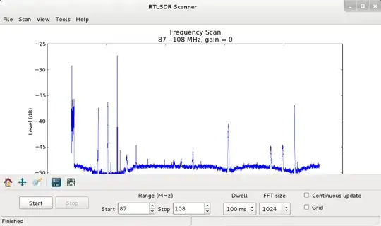

It's possible and there are tools out there to aid you in this.
Please see RTLSDR-Scanner which describes itself perfectly:
A cross platform Python frequency scanning GUI for USB TV dongles, using the OsmoSDR rtl-sdr library.
In other words a cheap, simple Spectrum Analyser.
The scanner attempts to overcome the tuner's frequency response by averaging scans from both the positive and negative frequency offsets of the baseband data.
It comes preinstalled with Kali Linux if you have a copy, and will looks like this (taken from the linked page):
Kali Linux installation of RTLSDR-Scanner
That said, I'm not sure if it supports direct sampling. If you plan on doing that, though, I'd consider chaining an upconverter.
