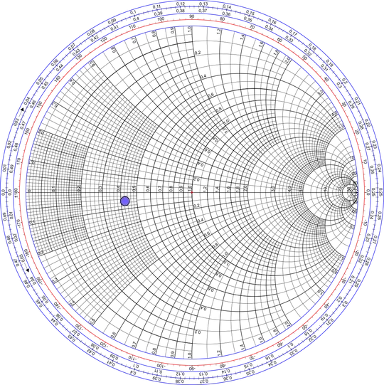

I find it easiest to visualize on a Smith Chart. Let's say we have a 300Ω ladder line, and a load (an antenna, say) with an (arbitrarily selected) impedance of (90+150j)Ω. In the Smith Chart, the center represents our target impedance (in this case, 300Ω) and all the impedances are normalized to that value. So we divide (90+150j)Ω by 300 to get (0.3+0.5j)Ω, and plot that on the Smith Chart:
By measuring the distance from the center, and the angle, we get the reflection coefficient in polar coordinates.

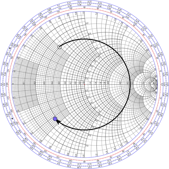

That's the impedance of the antenna at the feedpoint, normalized to 300Ω. Now let's add a 300Ω transmission line of increasing length, and consider the impedance at the end of it that would be seen, for example by the transmitter.
As the transmission line gets longer, the equivalent impedance moves in a clockwise circle around the center of the chart. This changes the phase of the reflection coefficient, but not the magnitude. Since the magnitude is constant, so is the SWR.
The distance moved around that circle depends on how long the transmission line is. When its a half-wavelength, it will have gone a full circle. A full circle is just a half-wavelength because the reflection must travel over that half-wavelengh twice: there and back.
We can stop at any time and read our new position on the Smith chart. Then, multiply the values read from the Smith chart by the normalized impedance (300Ω in our example). In this example, we end up at (0.28-0.43j)Ω. Multiplied by 300 makes (84-129j)Ω.

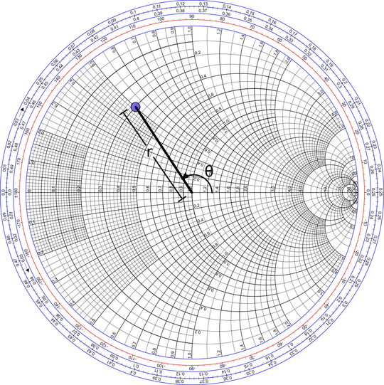

Now, let's add some 50Ω coax. Divide by 50 to get a normalized impedance of (0.42-0.645)Ω. Plot that:
As before, as the transmission line gets longer, the dot moves about the center in a clockwise circle. Multiply the final location by 50 to get the equivalent impedance seen by the transmitter.

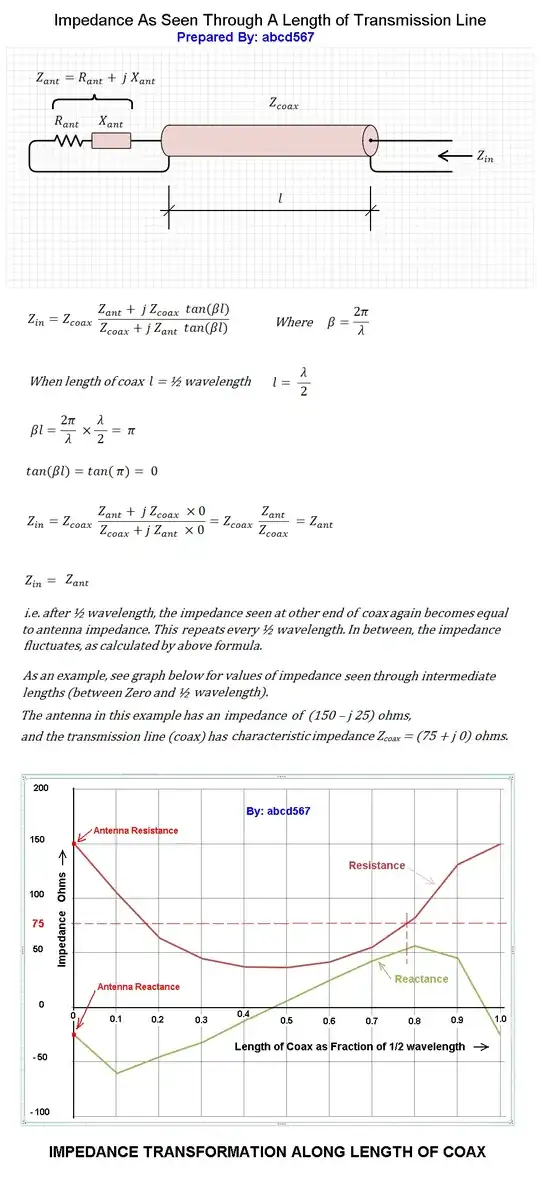

I am giving below the same answer, but in a mathematical form, in case some one is interested.

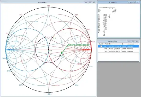

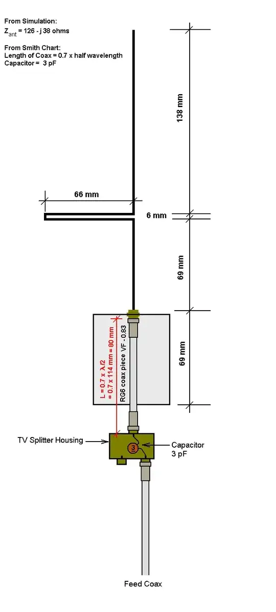

An example of use of phenomenon "adding transmission line changes the impedance seen by the transceiver" to match impedance of antenna to impedance of receiver
Receiver and coax impedance = 75 ohms
Antenna impedance = 126 - j38 ohms
Antenna is designed for 1090 MHz, λ = 275 mm
Velocity Factor of Coax = 0.83, 1/2 λ = 1/2 x 275 x 0.83 = 114 mm
Method:
Using Smith Chart, determine the length of Coax where resistance becomes 75 ohms i.e. transmission line circle intersects Smith Chart's circle R=1.0 (normalized to 75 ohms).
At this point (in this example) the reactance seen is inductive (+ve). Calculate the value of a capacitor whose capacitive reactance (-ve) is equal to inductive reactance. Placing this capacitor in series of coax core at feed point will neutralize inductive reactance and impedance seen =75+j0 ohms.
SMITH CHART
