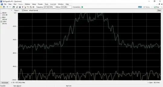

Unfortunately neither my location nor my messages showed up on ariss.net . I captured the signal by using a Tektronix PC-based spectrum analyser and got the following
Spectrum
Each box is 6khz wide. This means that at -10dB, the bandwidth is around 12000Hz which is more than I expected. So here are my two questions

    I have verified that the 9600 bps mode is switched off on the ICOM. How come the signal is that wide?

    The width is fine, remember you're doing AFSK, so the width of the signal depends primarily on the FM deviation. Isn't the ISS digi currently dead? That would explain lack of reception. – hobbs - KC2G Apr 16 '18 at 20:57
