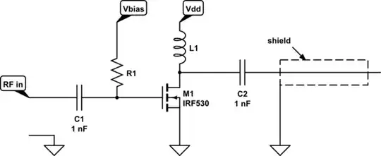

Coax is an unbalanced transmission line. The shield is held at ground potential. By that, I mean there is no voltage difference between the shield and Earth, the tower, the antenna, etc.
Neglecting biasing, impedance matching, and other details, you might drive it like this:

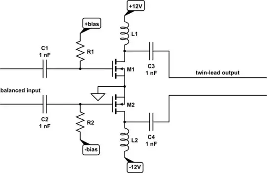

Alternately you can use twin-lead and make it a balanced system all the way. That might look like this:
schematic
simulate this circuit
In this balanced system, at every stage there is a positive polarity and a negative polarity half of the circuit, symmetrical in voltage and impedance relative to ground. There is no ground connection at the input or the output.

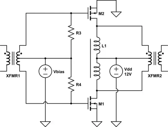

This balanced system has a significant disadvantage: everything is twice as complicated. One way to convert between balanced and unbalanced is to feed a balanced signal into a center-tapped transformer. The center tap, being halfway between the balanced inputs, is at ground potential.
That is why a class-AB push-pull amplifier is a common final stage, looking (simplified) something like this:
schematic
For a working example, see the HPSDR Pennywhistle schematic.
The input and output transformers do some nice things for us:
  • block the DC bias
  • allow for impedance matching by adjusting the turns ratio
  • provide galvanic isolation
Galvanic isolation is especially pertinent to your question. You'll notice there's no DC path from the amplifier to either the input or the output. So ground doesn't really matter: only the current through the transformer matters. So you can connect one end of either (or both) transformer to ground, or you can make a balanced connection and not connect ground at all.
Furthermore, consider that noise on ground is still noise. With the antenna isolated with a transformer you can avoid any possibility of ground loops which will pick up noise, and it's easier to isolate the ground reference for the receiver front-end from the digital noise, etc that might be present elsewhere.

  • Say my coax impedance and dipole antenna impedance is close enough so that I don't need any matching. In that case say I decide to drive my antenna through the first circuit in your answer. But here I again face the ground issue as the coax shield is grounded. As I don't have transformers at my disposal. My plan is to use the first circuit. – user3001408 Feb 15 '17 at 06:13
  • @user3001408 It will work, for sure. The main issue is to make sure the PCB layout keeps the ground currents quiet for the receiver. With the antenna isolated with a transformer it's much easier since the grounds can be isolated. – Phil Frost - W8II Feb 15 '17 at 17:22
