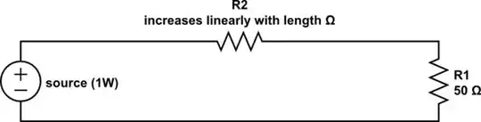

Firstly I would note that your initial statement isn't true. Indeed, the resistance of a wire increases with length, but resistance isn't loss in the same sense of transmission lines where loss is measured in power or a ratio of powers. Consider:
schematic
simulate this circuit – Schematic created using CircuitLab
$$ I_\text{source} = I_{R1} = I_{R2} = \sqrt{1 \over R_1 + R_2} $$
$$ P_{R2} = I_{R2}^2 R_{R2} = {R_2 \over R_1 + R_2} $$
Replacing the source with a constant current or a constant voltage source we can make some linear relationships to length, but under those conditions source power changes with length also. This isn't the same sense of "losses" used in transmission lines which compare how much power from the source makes it to the load.
But this doesn't answer your question: although the relationship isn't linear, neither is it what's expected of a transmission line:
$$ P_\text{out} \propto 10^{-l} $$
