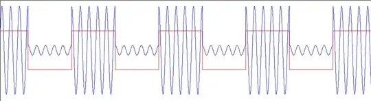

For AM, we modulate the amplitude of that signal. Let's say the baseband signal is a square wave. Here's an example of a "loud" square wave and AM, with the baseband in red, and the output in blue.

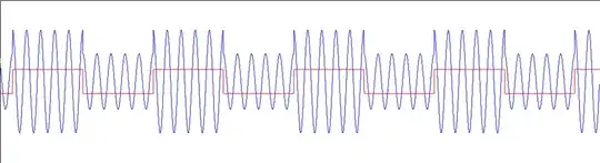

With a quieter baseband input, the variation in amplitude of the output is less.

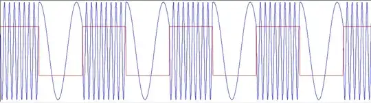

For FM, we modify the frequency instead of the amplitude. Here again is a loud square wave. Note the large variation in frequency between the periods where the square wave is a large value, versus where it's a low value:

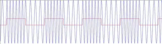

With a quieter baseband input, the variation in frequency is less:

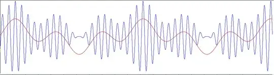

Of course in practice the baseband signal will be something more interesting than a square wave. Here's an AM example with a more complex input:
Note the baseband waveform can be anything at all: it can have any number of frequency components, at any number of amplitudes. But that's not necessarily relevant: all we need to know at any instant is the value of the baseband signal, and that's what the amplitude of the carrier is.

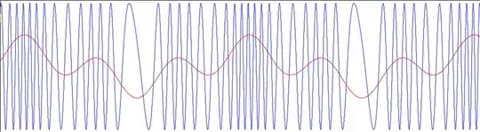

And now with FM:
