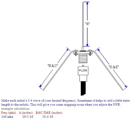

The radials are not connected to the earth. Here's a photo of a ground plane antenna. They are connected together as shown to the coax shield. This shield should be connected to the common on the board that can serve as an RF ground.

I think the best answer to your question can be found HERE - the basic concept is shown in this diagram:
2M Ground Plane Antenna
