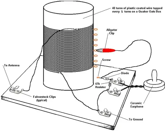

I'll be visiting home soon after school lets out, and I want to build an AM crystal radio with my little brother. This is the design we'll use:
http://crystalradio.net/beginners/
I'll be doing my best to explain to him how this works. I understand that when a radio ray passes over an antenna, it generates an alternating electrical field in the antenna wire. If the antenna wire is the correct length for the given radio ray, the electrons in the wire will bounce back and forth in sync with the alternating field, moving faster and faster with each oscillation (resonance). I also understand how audio can be embedded in an AM signal using amplitude modulation.
However, I do not understand the diagram in the diy linked above.
  • Where do the electrons flow?
  • Doesn't splitting the circuit in the middle of the coil create two "antennas", each with a different resonant frequency?
  • What is the purpose of the resistor? I have looked up the internal design of piezoelectric earpieces, and it does not appear that current flows all the way through them.
The circuit I've chosen is similar to, but different from, the circuit shown here:
wikipedia https://en.wikipedia.org/wiki/Crystal_radio#Design
I was able to find some helpful material on the howstuffworks pages for AM radios, but it is not a one-to-one mapping of the design proposed in the first diagram.

However, I do not understand the diagram in the diy linked above. Where do the electrons flow?
diagram from DIY article
So, the electrical field pushes and pulls the electrons in the antenna back and forth – that push/pull extends down the antenna wire up into the coil – which basically acts like a reservoir of water. You push in a little current, the next moment you pull it back out, and so on.
Now, the size of that reservoir determines at which frequencies we are in resonance. Which means, the amount of windings that are effective in the coil determines how much current can flow into the coil, get its energy stored in the magnetic field of that coil, and then flow back.
By selecting less or more windings with the alligator clip, you get less or more reservoir – thus, you change the resonant frequency of the antenna/coil system!
Kind of, yes! But the other half (not attached to the antenna) is attached to ground, so nothing is received there. Keen observation!
Exactly. Piezoelectrics react to changes in voltage, and other than that, basically isolate. To allow net current flow from the diode to ground, you'll need something that always passes current.
Now, using this resistor means that you won't get all energy that you've received to drive your ear piece, but that's not all that bad.
I hope that gave you a start :) Would love to hear your feedback, and see you back around here :)

  • This is great. Thanks very much for the detailed reply. I thought that the purpose of the coil was only to change the length of the antenna, but if I understand you correctly the purpose of the coil is actually to store the "momentum" of the electrons with inductance, do I have that right? Also, I read about the diode. I see that electrons only flow from the side with the black ring to the other side. So electrons can only enter the antenna? Do they leave through the "dead" half of the antenna? – BitPusher16 Apr 17 '17 at 14:27

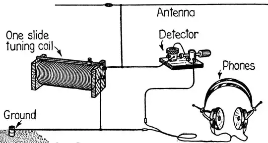

  • A few suggestions: **(1)** Neither circuit has a capacitor in parallel with the phones. The resistor should be replaced with a small disc ceramic capacitor, IIRC about .0005 to .001 uf as an RF bypass. **(2)** The headphones/earphones *must* be high-impedance (in the 1000s of ohms); common low-Z earbuds for a stereo will produce no sound. **(3)** The antenna in this circuit has capacitance to ground, and so that and the coil form a resonant (tuned) circuit. That means if the antenna is too long or short, it may have too little or too much capacitance to resonate with the coil in the AM band. – Mike Waters Apr 20 '17 at 17:48
  • @MikeWaters: The ceramic earbuds I've seen behaved more like capacitors than resistors, and would thus need parallel resistance. Some other earphones use coils and thus behave like a resistor or (to a slight extent) inductor, and would thus benefit from parallel capacitance. That having been said, I can't think when I last saw ceramic earbuds for sale. – supercat Aug 20 '17 at 18:28
  • @supercat My regenerative receiver would not work without a bypass cap across the headphones. Maybe that's what I was thinking. – Mike Waters Aug 20 '17 at 18:39
    @MikeWaters: My 1970s 75-in-one and 150-in-one kits both came with a ceramic earbud, and I've used those in crystal radios without a bypass cap. What's necessary is to build something that can act as a peak detector, which in turn essentially requires a diode and something that acts like a parallel RC. BTW, there can also be advantages to adding some parallel capacitance on the other side of the diode, but knowing what cap to use would require knowing the inductance of the coil. – supercat Aug 20 '17 at 18:47
