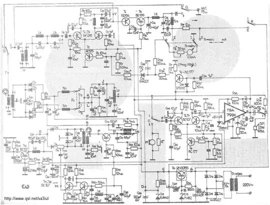

Poking around on the net, there are a bunch of QRP 10m transceivers that could be built into a walkie-talkie form factor. This one looks pretty doable: 10m SSB Transceiver
The only IC is a small op-amp for the audio out. Looking the schematic over, it's setup for 220V AC power (the author is Australian, but he's probably OK despite that :) ). Since you are going to want to run on battery, you can axe that whole section and wire the DC source right in.

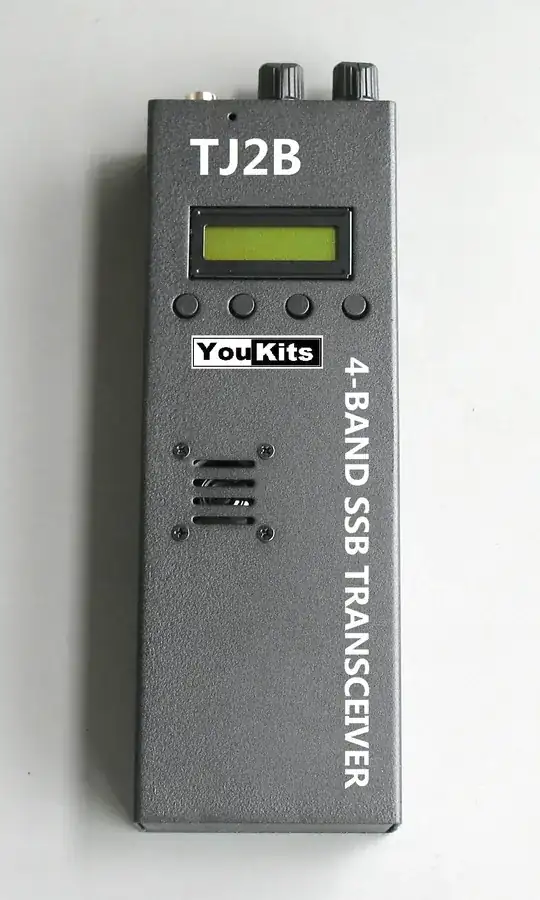

The only HT kit I've ever seen in my searches was the "TJ2B MK2 5 Band SSB Handheld Transceiver" from Youkits.
From Youkits themselves:
TX/RX: 5-21MHz, covering 60m, 40m, 20m,17m and 15m band (No TX on 30m)
So it won't work on the 10m band, but it will work on 5 other bands.
However WB8YQJ's eHam review says this:
The new TJ2B "Kit B" seemed ideal, offering 14Mhz to 30Mhz SSB +(CW Receive) in a handheld case and $269 plus ship. enter image description here
  • The TJ2B shows sold out on the YouKits web site, and the last update there is from 2015 (i.e. answer is now obsolete). Further, they apparently only sell "fully assembled and tested" products now. – Zeiss Ikon Jul 05 '19 at 15:40

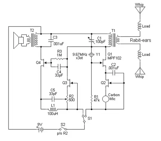

Simplex 10M AM HT
About as simple as a half-watt can get.
