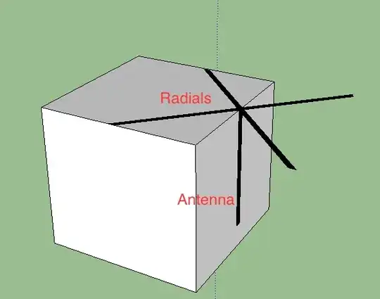

I know many people have the antenna facing straight down (with radials attached to the bottom of the payload). However I want to use a satellite tracker as a backup, which means the tracker should always face the sky. If the antenna were at the bottom, the payload would probably fall over when landing... Would it be bad for reception, if i just put the antenna on a side of the payload instead of the bottom? (meaning the radials would be taped to one side of the payload and the antenna would be horizontal). As the HAB will be bobbing around a lot in the wind, would it even matter in which direction the antenna faces?
EDIT: Might the way of attachment shown in the picture be a solution? Possible solution?

  • Thanks for your answer. The trouble with mounting an antenna on the bottom of the payload is that it would make the payload tip over at landing, meaning the satellite tracker would no longer face the sky and loose its signal. You said that The styrofoam is rf transparent. That made me think, maybe you could mount the antenna like in the picture I added to the question right now (see above). Would that work? There may be some circuitry directly below the 2 radials which are on the top of the payload. – user5227744 May 02 '17 at 11:58
  • With the antenna made as suggested, it will likely fold over on inpact to the ground. Were you to install it the way you have on that picture you would stand a pretty good chance of completely detuning it because now the contents of the box are inside of the transmission plane as opposed to below it or in this case above it. You'll end up with three antennas per one for the SAT tracker, one for the GPS and one for the downward-pointing radio. Once the unit is on the ground you won't be getting updates for position but you won't need them either because you'll have the last update of position. – Rowan Hawkins May 02 '17 at 13:01

Advantages of the upside-down monopole include:
  1. It's omnidirectional in the azimuthal plane, so as the balloon rotates the antenna gain doesn't change much.
  2. The gain is higher in the down direction towards Earth.
The ideal radiation pattern of a monopole like this is a bagel sliced in half, with the monopole sticking through the hole in the center. With a ground plane of finite size it changes a bit but this is still the general shape.
With the antenna mounted on the side, half that bagel will be pointed up to the sky where you'd just be receiving noise (though not much of it since there aren't many radios up there) or wasting transmitter power. And as the balloon rotates the pattern changes: when the antenna is on the far side of the balloon relative to your base station, gain will be pretty low.
This may or may not be a problem. Ultimately it depends on the reliability you require and your link budget. You can use antenna modeling software to estimate the antenna gain, or build a prototype and test it empirically.
