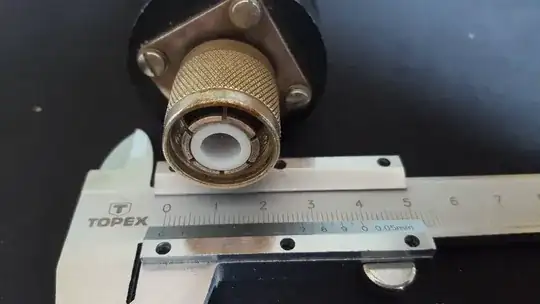

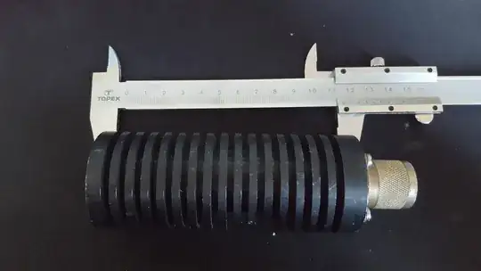

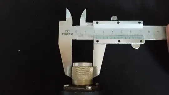

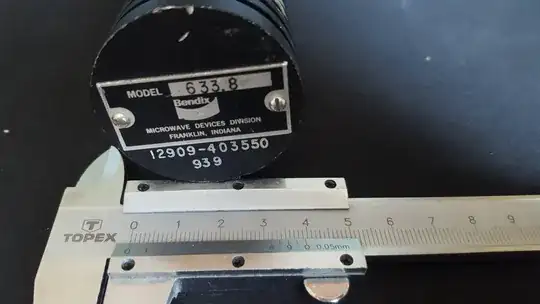

I have recently acquired a nice looking dummy load on military surplus sale. Being relatively new to the hobby, I assumed the connector on it was something common. Turns out it is not. So far nobody has been able to tell what it is. The most specific answer I got is that it is a 'large TNC', except I haven't been able to find anything like it. Looking for the model number on the manufacturer’s site also didn't bring up anything useful.
I thought also of replacing the connector entirely, but it turns out that the center pin and dielectric are integral parts of the resistor inside.
Here are a couple of pictures of the load and the connector up close.
The connector
The connector head on
The connector diameter
The load from the side
The load's model number

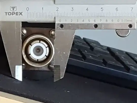

    It might be useful to take a picture of the connector directly end-on, from as far away as still gives decent resolution (for minimum perspective distortion). This will allow people to get dimensions of the subcomponents of the connector from the photo. (On the other hand, if someone already knows it, that probably isn't necessary.) – Kevin Reid AG6YO Jun 21 '17 at 17:20
  • @KevinReidAG6YO thank you for suggestion. I've just added such a picture. – Mchl SP5MKL Jun 21 '17 at 17:33

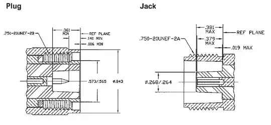

The connector is called an "HN" type connector. It has a 3/4-20 thread and it is usable up to 4 GHz. The Amphenol data on it is available here.
Glenn W9IQ
  • 18,498
  • 54
  • This might be it! The dimensions are pretty much spot on. Now I just need to find a place which wouldn't charge me $50 for a female connector (these are the prices I can see at local vendors). My best bet might be to drive back to place where I bought the load and dive into their bins of disassembled connectors. – Mchl SP5MKL Jun 22 '17 at 19:03
  • I can assure you that is the right connector. I looked up the specs on your Bendix 633.8 and then confirmed the dimensions just to be sure. – Glenn W9IQ Jun 22 '17 at 19:06
  • Glenn, where were you able to get the spec for the dummy load? I would be most interested in having a look at those too, to know exactly what I bought. – Mchl SP5MKL Jun 22 '17 at 19:08
  • Try this link: [link] (http://www.webflis.us/webflis.aspx?NSN=5985-01-034-8226) – Glenn W9IQ Jun 22 '17 at 19:22
