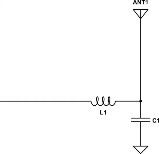

A simple tuner might be just a capacitor and an inductor:

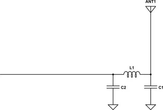

For more flexibility, many tuners add a 2nd capacitor to make a pi network:

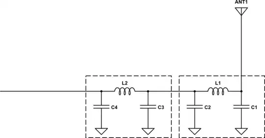

If you were to have two such tuners:
schematic
simulate this circuit
Well, now you just have more elements which can be adjusted. There's nothing inherently wrong here. In fact it gives you additional tuning range.
Internal tuners usually do not have much range, and it's likely with an external tuner you won't even need the internal tuner. You might consider simply disabling the internal tuner. Or if your external tuner is manual, you could adjust it for a good match at the middle of the band, then enable the internal tuner to compensate for the slight mismatch as you move within the band. If the external tuner is automatic, I can't really think of a reason you'd need both.
