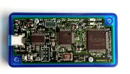

The DVDongle contains the same ASIC, visible here as the large IC on the right, with "AMBE-2000" printed on it:
The middle IC is at Atmel microcontroller, and the IC on the left looks like an FTDI USB interface. There's not much else to it.

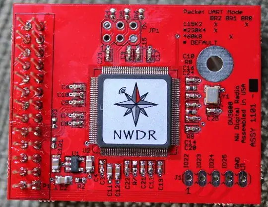

The DV3000 from NW Digital Radio provides the AMBE Vocoder. One person has modified Digital Speech Decoder (DSD) to use it instead of reverse engineered library, it is also supported by other solutions such as G4KLX's DummyRepeater. An AMBEServer, (Raspberry Pi + DV3000) on your LAN would provide Vocoding to a SDR if the proper protocol and modulation components were available.
The UDRX-440 is a band limited SDR which will provide GMSK modulation and use the DV3000 internally to provide D-STAR Digital Voice.
