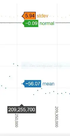

I have sampled a section of spectrum every few Hz. I have mean, standard deviation, and range data for every frequency sampled (and I can gather more statistics if necessary). I've sampled for several seconds before storing the spectrum statistics.
I would like to be able to guess where man-made signals (i.e. channels) exist in this spectrum (as opposed to noise floor). This is proving to be a difficult task, especially since the noise-floor power sometimes changes (different antenna inputs for different bands, for example.)
I doubt anyone has a ready solution for this, but what are some starting points, or tips, to help me begin to identify channels?
In the below image 'normal' is really autocorrelation from Pandas 'normal' is really autocorr from Pandas

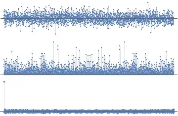

Here are a few examples to illustrate the autocorrelation/power spectrum approach. In the images, I plot the signal first, then the power spectrum, then the autocorrelation. These are simulated signals with sampling interval $\Delta t = 1$.
White Gaussian noise
Flat power spectrum, autocorrelation has a peak at zero lag, flat everywhere else. white Gaussian noise

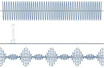

FM with sinusoidal modulation
Easy to see in both the power spectrum and autocorrelation.

  • I have many samples and have performed the FFT. There are several spikes or humps that correspond to man-made (modulated) signals that are easy to see, but are difficult to find algorithmically. It sounds like from your autocorrelation description, I'm looking for just one signal, not many (as exist in the spectrum currently.) For example, you use "the peak", singular, in your description. This is what's confusing me. – Ken - Enough about Monica Jul 20 '17 at 15:33

  • Please see the image I added to the question. I am indeed taking the FFT with numpy. The data in the graph that says 'normal' is really the autocorr output from Pandas. It's always very low. At the peak you see there (one of many peaks (man-made channels, such as FM broadcast stations) in my graph. Pandas' autocor gives -0.05 at the peak of that channel (just left of where the marker is). So the Pandas approach doesn't seem to be working. I'm guessing from context that the autocorr approach you give is for one signal, not a frequency domain spectrum containing many signals? – Ken - Enough about Monica Jul 21 '17 at 09:33
