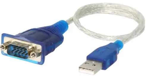

The paddles connect via a standard FTDI-based USB-A Male to DB9-Male Adapter cable.
