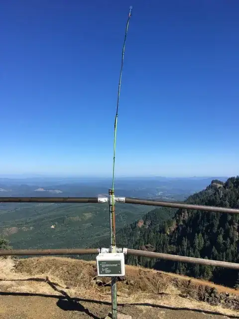

Some friends and I recently placed a Kenwood TH-D72 on the summit of Saddle Mountain in Oregon, USA, and set it up as a temporary digipeater for use with APRS.
Digipeater on Mountain
The TH-D72 successfully digipeated packets, but when our hiker summited the mountain again the next day, he found that TH-D72 was stuck on the startup splash screen and was unresponsive to any button presses (other than powering off).
I haven’t been able to find any reports of a TH-D72 freezing on the startup splash screen. Does anyone have experience with this? What is a likely cause of this behavior? We haven't seen the TH-D72 freeze on the splash screen before or since.

The radio was powered by YUASA NP7-12 12V,7.0h battery and 12V to 7.5V switching regulator. The battery manufacturer recommends keeping the battery between –15°C and +50°C for charging and discharging. The temperature on the summit was likely between 4°C and 32°C. The enclosure was vented with a fan.

I assume you have extensively bench tested the kit and have not found any problems.
Having several years of experience with high altitude radios in the Alps, I would suspect that you are getting static build-up on the antenna that is glitching the radio.
A Polyphasor, or equivalent, to ground can mitigate static build up. Failing that, a couple of megohms of non-inductive resistance across the antenna terminals may help. I have had success with the resistors in an N connector, plugged into a Tee connector at the radio.

  • "Polyphasor" is a brand name for a surge arrestor, right? I assume any RF surge arrestor would work. You mentioned, "Polyphasor... ...to ground." [The arrestor I've seen](http://manuals.solidsignal.com/Manual_for_IS-B50LN-C2.pdf) has a terminal for the equipment, one for the antenna, and a mounting hole on the bracket. I assume you mean, "ground the bracket"? – watkipet Sep 06 '17 at 17:58
  • Yes, we did extensively bench test it (and in stationary vehicles). Saddle Mountain is only 3,287′, but it's the tallest point the general area. The box and antenna were mechanically, but not electrically, attached to a galvanized steel railing. – watkipet Sep 06 '17 at 18:04
  • @watkipet Yes, Polyphaser is a brand name. Connect its ground connection to an earth ground. – Glenn W9IQ Sep 07 '17 at 04:28
  • While I can't positively confirm that this is the answer, I'm going to mark it as such since it seems the most plausible. Thanks! – watkipet Sep 07 '17 at 04:53
