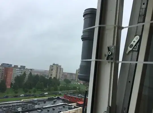

I mounted a small RX antenna (mini whip, bought from eBay) (on 10-th floor) and I want to try to listen to something. I bought a RTL-SDR with Upconverter which supports HF. RX antenna's operating range is 100kHz - 30Mhz.

My antenna:

    How have you grounded your antenna? Is the window frame or other nearby structure conductive, and if so do you know if it is grounded? (See the recent additions to my answer and the new link(s) — the miniwhip needs a good ground, but the antenna "whip" part shouldn't be blocked/shieled by it either.) – natevw - AF7TB Sep 15 '17 at 21:02
  • Antenna has power unit. I connected gnd connection to pipe (radiator) in my home. Is it correct solution ? – kesrut Sep 16 '17 at 19:11

Another picture of the antenna, from somewhere
A miniwhip (see also this article and this PDF) is an active antenna taken to the extreme: it uses a tiny conductor to intercept a tiny bit of broadband electromagnetic field, and then amplifies it by a huge amount — perhaps on the order of +35dB gain.
Being an active antenna it will either need to be plugged in to a DC power source, or (as is more typical) you can "phantom power" it via a bias tee.
Also, the antenna is amplifying the difference between its whip/plate and its ground:
without any conductive connection to the outside, the entire circuit will be at the same potential
The typical installation recommendation has you attach the ground (or the shielded outside of its coax connection) of the miniwhip to a conductive and grounded mast. For example, this eBay listing mentions:
For max. sensitivity:
  • this antenna should be positioned as high and free from metal conductors as possible.
  • the ground plane of the PCB must NOT be lower than the top of the mast. (the connection to and the antenna surface itself must be ABOVE the top of the mast).
For best signal-to-noise ratio:
  • install the Miniwhip onto a well grounded mast.
  • connect "GND" of the Miniwhip PCB to that mast.
  • place HI-Ui ferrite cores […] on the beginning and end of all cables to block cable noise currents.
Generally with this antenna you are encouraged to avoid electrical noise on the whip and/or its grounding as much as possible. However, that may be something to go back and optimize after you've addressed the next topic…

    Does this antenna work well clamped to a window frame like shown in the OP? – SDsolar Sep 15 '17 at 06:07
    @SDsolar Hmm, browsing http://www.pa3fwm.nl/technotes/tn07.html it reminded me of one more thing (which I'll also add to my answer) is that the miniwhip wants to be cleanly grounded. You want the whip and the ground to be as noise free as possible, some window frames might be great but others might be terrible. PA3FWM's famous WebSDR uses one on a rooftop, but it is a metal roof: http://websdr.ewi.utwente.nl:8901/ – natevw - AF7TB Sep 15 '17 at 20:44
  • I would think an aluminum frame that is articulated would be a very noisy ground, if it is grounded at all. Like using the frame of a mobile home instead of driving a ground rod. I would suggest that on the 10th floor as per the OP a water pipe would be best, with the ground at the receiver end as shown in the diagram at that link, eh? – SDsolar Sep 16 '17 at 01:00
