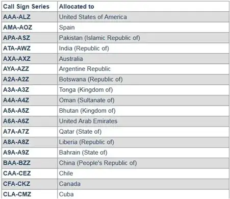

The ITU is the international body responsible for the allocation of call sign prefixes to each country. You can consult this table of allocations in order to build the necessary logic in your program to determine if the call sign in question meets your award requirements.
An example of this table of ITU allocations can be found at: http://www.arrl.org/international-call-sign-series
Here is a snip of that table:
As an alternative, you could subscribe to the QRZ.COM call sign lookup service. The data is exchanged via XML so you could resolve the country from the appropriate XML tag. This may not be fool proof, however, if the call sign in question is not in their database or if the entry contains an error.
