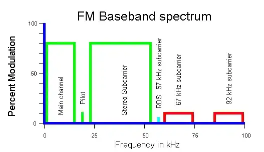

Bandwidth: Broadcast FM stations are spaced 200 KHz apart, with the intention of allowing this kind of signal structure without interference:
The FM broadcast bandwidth of just more than 50 KHz is quite sufficient for near-CD quality stereo.
Normal broadcast FM uses multiplexing so the main channel includes L+R - both channels - what we call Mono. Then there is a subcarrier that sends L-R. The receiver detects the pilot signal (subcarrier) and lights up the "stereo" light, so the receiver knows to use a demultiplexer to separate the L and R signals which it then sends to your amplifier and speakers.

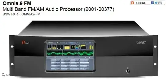

Sound quality: FM broadcast stations always use audio processors that are specifically tuned to make it sound better than any handheld radio's microphone circuitry will be able to duplicate.
(This one is roughly $10,000)
They also incorporate pre-emphasis so the roll-off of higher frequencies in the receiver IF bandpass filters are not as audible.
Dolby sound operates on a similar principle - to counteract artifacts introduced by the entire receiving chain including the speakers.
It takes a lot of work to properly tune the audio processor at a broadcast station.
Thus there is no comparison to a ham signal with 5 KHz deviation and no audio processing, with a small microphone. It can be easily heard.
