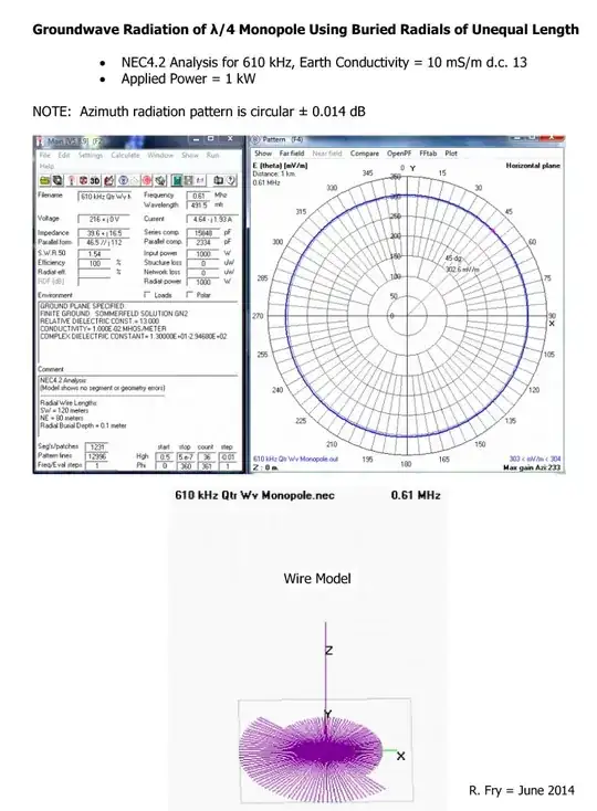

The effects of using unequal length buried radials on the radiation patterns of a monopole are not very significant, as shown by the NEC4.2 analysis below. enter image description here
