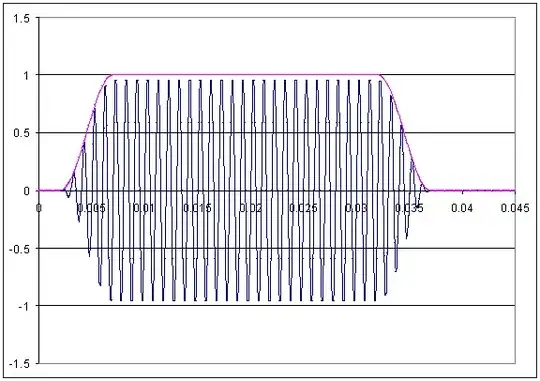

CW transmitters always begin at zero output (what you are calling a zero-crossing, but at the boundary condition) until they are commanded to produce a signal by the closure of a contact on a key or by other means. Then they return to zero when that output command is removed.
CW transmitters do not come up to full power instantaneously, and produce waveforms like this:
Note that as this is displayed in the time domain relative to the keying frequency, the actual carrier is not visible.
So even if the modulation itself (the key, acting as a switch) is a square wave, the resulting output is not truly square due to the physical constraints of the components of the transmitter.
This is true for both the rise and fall of the envelope.

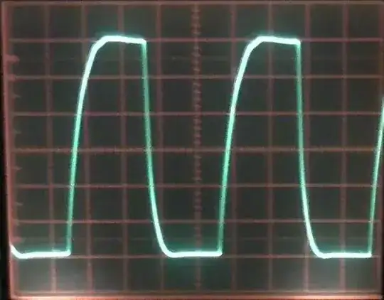

Here is another example:
In this plot, relative to the carrier frequency, it is clearly seen that in a practical sense the transmitted wave envelope does indeed begin and end at the boundary conditions of zero.
Of course, philosophers have been known to argue that it never actually reaches zero - just gets closer and closer to it. Then the quantum physicists bring up the Planck limits, and so on, ad nauseaum.

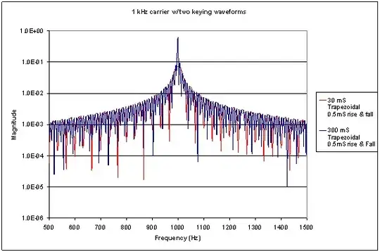

In the frequency domain it will look like this:
Note that this is a plot of a signal modulated by 1 KHz square-waves, which is why the bandwidth is spread so widely. At 1 KHz keying, the ratio of signal to modulation frequencies are getting to the point where it is producing sidebands. The amplitudes of the sidebands fall off in the normal way. This plot does not show the effects of input filtering.
Consider a generic mixer circuit - the output should always be filtered in such a way that only the desired modulated carrier is the resultant output.
The risetime portion is as if it has been modulated at some very high rate. That produces spurious emissions in the driver circuit which are then filtered out. They should not be within the bandpass of the final power amplifier.
But since no filter is perfect some of those spurs will end up on the output. Hence the need for guidelines regarding limitation of spurious emissions. These are specifically regulated for FCC Type-Accepted commercial transmitters.
