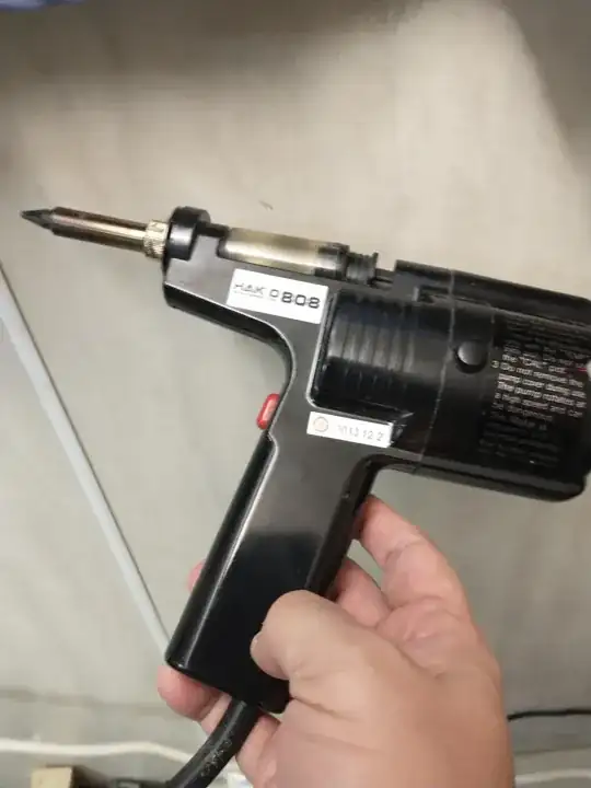

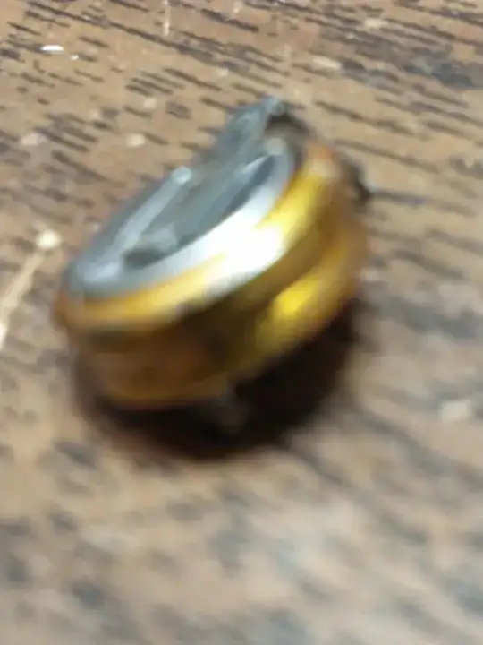

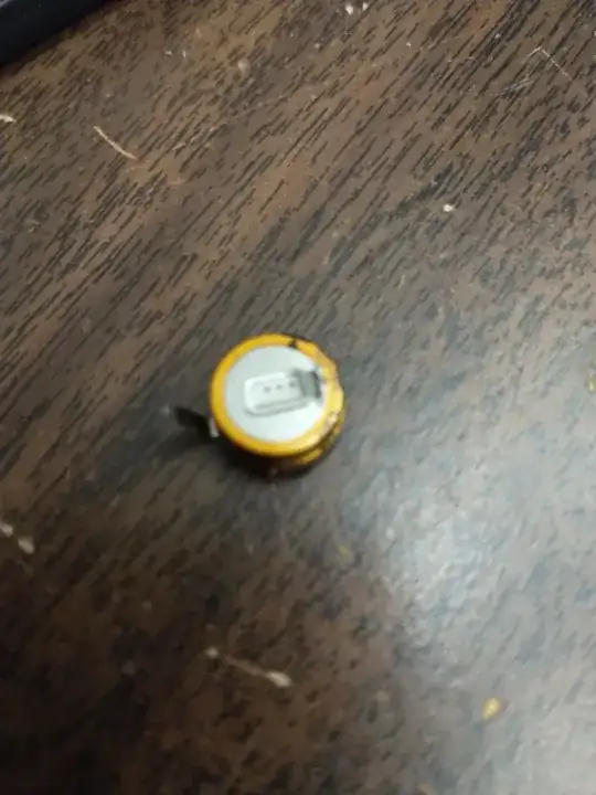

I signed up here just to reply to this great (the only one I could find on the internet) question/experience that helped me with an identical problem. I was so close to giving up when I read this thread and went to examine the component that looks like a coin battery (as the original poster described) enter image description here enter image description hereand having owned a sucking hakko soldering gunenter image description here, i managed to remove it from the board (you'll have to remove the metal shield under the board first, which makes it even harder, but a piece of cake for an expert like me). I then soldered two tiny wires to it's pins and connected to a power supply that I started at 1.0v and incremented 0.1v at a time. The radio's dead screen came to life at 2v and everything was normal. The screen was on even with no AA batteries, but the "low battery" symbol was blinking and the radio won't turn on until the AA's were installed. This component looks like two small coin batteries stacked over one another. Upon further investigation, I discovered that it is actually a very small super capacitor of .22F and 5.5v that is relatively expensive (around $10 a pop). I put a 2200uf that i had and the screen came on for only a second. I'm not sure if supercaps (very high capacitance electrolytics) can be tested just like a regular cap and if they have a short life time but i'm still researching and would love to hear from others (especially the original poster from 4 years ago!). It could be that tecsun put very bad quality component there purposely to sell more radios!!! that's for them to answer.
