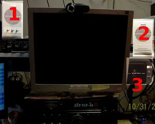

    @William-Rem I suggest you get some with bass and treble controls, which are useful on mine (1 and 2 in the photo). _Having said that_, I have some really cheap ones without any, that might even be better than those old Altec-Lansings (which I bought years ago at a yard sale) that came with a subwoofer (not needed!). Nothing beats headphones. Mine are military surplus, and are *perfect* for communications, much better than hi-fi stereo music phones, earbuds, etc. – Mike Waters Nov 01 '17 at 22:28

The sound from the small tinny-sounding speaker in the top cover of that IC-765 under the monitor kept me from hearing the people that I was ragchewing with on HF SSB. So, I added those speakers, 1, 2, and 3. They are all connected to my transceiver. Tuning to any SSB signal on the HF bands, the sound from them is very clear and easy to understand. The same would be true for narrow-band FM signals.
W0BTU speakers
Speakers 1 and 2 are older Altec Lansing computer speakers. Even though they were not intended for amateur radio, they sound great and I highly recommend them! Get some computer speakers and try them.
Speaker 3 is an older Am-Comm Inc. digital ClearSpeech™ speaker. Most of the time, the digital noise filter is off, but it still adds a few highs that the computer speakers lack. Am-Com has since been acquired by another company which added several adjustable levels of digital noise filtering that made it an even better speaker (so others have told me).
