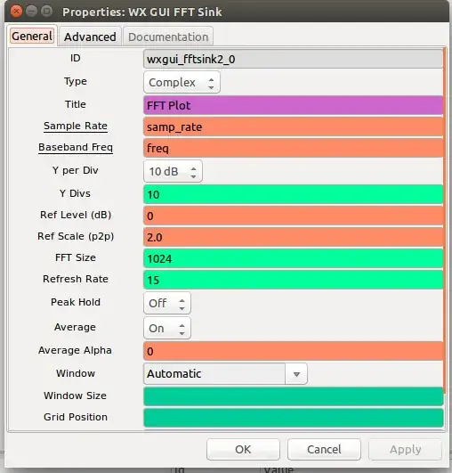

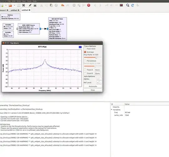

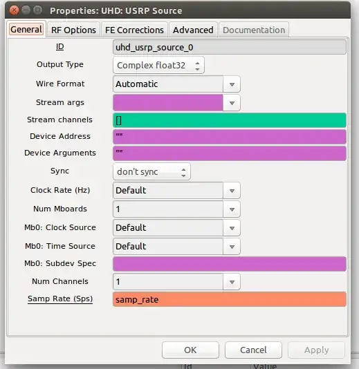

My issue is regards to viewing the FM spectrum using USRP N210 & GNU Radio. I did try to use several blocks of GNU Radio to view an FFT plot of the FM band using the USRP N210 device. My blocks and results are as below,
I used my mobile phone to listen to 90.5MHz FM channel and confirm that there was indeed a working FM channel at that. Actually, there has to be multiple channels in this band.
In many FM radio examples, it is possible to observe multiple bands of FM channels. Unfortunately for me, I cannot see a single one. I feel that there is something wrong with my setting in GNU radio. I post the settings I have applied to each box below.

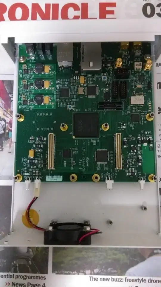

To support Marcus's second answer, I post an image of the inside of my USRP N210 below.
It would be really great if my mistake can be spotted.

I don't see anything wrong with your basic GNU Radio flow graph, so it is likely a hardware configuration issue.
I'm not familiar with the USRP N210 in particular, so this is a bit generic:
  • In my experience, the most common software reason for getting no visible signal is incorrect gain settings. Is 15 dB an appropriate middle-of-the-road setting or is it too low or too high? I don't know what the minimum and maximum supported by the hardware are, but the FFT plot looks more like an overload than below-the-noise-floor, so try reducing it.
    In extreme cases, such as if you live near a broadcast station, you might even need an external attenuator.
  • You have selected antenna port RX2. Is your antenna actually plugged into that port, or a different one?

    excellent! By the way, when you select "relative" as "gain type" and use "0.9", you get "high gain", no matter what daughterboard you use. – Marcus Müller Nov 03 '17 at 22:01
  • Dear Kevin, Thanks for your time. I did try different gain settings but my results were same. I also tried by fixing a wire to the USRP to mimic a FM antenna as I was using a 868MHz antenna earlier. Both my USRPs give same result. I can guarantee there is no FM transmitter near where I live. May be its my installation? Perhaps the GNU radio version and the UHD ETTUS client dont match. But then, how do I see some spectrum anyway. I'm a little lost as I cant even do this simple thing. Please do tell me if you need any other additional information. – Denis Nov 04 '17 at 09:39

  • If you really see nothing but this ca 0.005 amplitude peak in the middle, I'd argue you've got LO leakage. However, you have a very wide "hill" around that, as if lots of interference gets mixed down there. That is strange.

  • Dear Marcus, none of the USRPs I received from lab came with any daughter-boards. When I opened the original packaging of the USRP, it was just a plain single board inside the white metal box. No daughter-board was plugged in. I apologize for this question, but do I need a daughter-board even to receive ? I will attach a photo of the inside of the USRP below. – Denis Nov 04 '17 at 10:50
    Yes, you will need a daughterboard. – Marcus Müller Nov 04 '17 at 10:52
  • I updated the question with a photo of inside of the USRP N210. So is there no way i can even receive a simple spectrum like FM without a daughter-board? Thank you so much Marcus. Can you please guide me to ETTUS documentation I must read prior to using the USRP N210. I really don't want to do any more stupid mistakes like this again. – Denis Nov 04 '17 at 11:01
    The daughterboard contains practically **all** of the analog electronics you need for reception. Yes, a daughterboard is necessary for any kind of usage of an N210. – Marcus Müller Nov 04 '17 at 11:04
  • I really appreciate your efforts. A sincere thank you. And apologize for wasting time on a problem this obvious. – Denis Nov 04 '17 at 11:06
Your uhd_usrp_probe output shows:
|   |   |   |       RX Frontend: 0
|   |   |   |   Name: Unknown (0xffff) - 0
and
|   |   |   |       TX Frontend: 0
this is typically the symptom of a not properly connected daughterboard, or one with broken power rails; less often, sign of a corrupted daughterboard eeprom.
Please try to take out and plug back in your daughterboard (you still haven't told us which daughterboard model you're using!), and try again.
