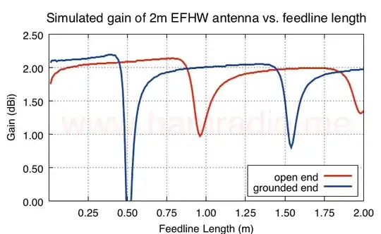

I performed some simulations of an end-fed dipole system with an autotransformer and an additional wire representing the currents along the feed line. I did so with the wire open ended and with a couple 1/4 wave radials to represent both ungrounded and grounded situations. In the article I look at SWR, Return Loss and antenna gain in the axis of only the antenna radiator. All tell the same story, but gain gets the nod to view for this answer...
Gain (Theta) of EFHW vs. feed line length
Key points include:
  • Feedline lengths up to near 1/4 wave do not cause much trouble for either case. This jives well with the many reports of successful portable operations using EFHW antennas with very short feed lines.
  • Whenever the feedline presents a high impedance to the antenna feed, current is drawn from the primary radiator resulting in perturbed performance and lower gain.
So to answer your question if the feedline is under 1/4 wave in length, there appears to be no reason for a current choke. However, if you have lengths 1/4 wave or longer, it may be time to add one... but where?
If my simulations are correct, placing the high impedance of the choke 1/4 wave back should provide protection to the system for any length of feedline past the choke since the choke always forces a low impedance (1/4 wave transformer) at the feed point that is very dissimilar to the high impedance feedpoint. This odd phenomena is reverse of the case of a center-fed dipole or 1/4 wave monopole.
