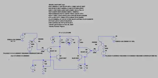

Clearly I am not going to drop an entire Atmega328 into a SPICE simulation, so in LTSpice I used a bunch of independent voltage sources to recreate what I expect out of my DAC. The definition of the MJE13007 comes directly from on-semi's website.
  • V1 and V5 form the expected 0 to pi sinewave output from my DAC. The negative portion is irrelevant
  • V3 and V6 form the two square waves from my DAC
  • Q3 and Q6 are the "enable" PNP transistors for the darlington circuits
  • Q1, Q2, Q4, and Q5 are the two darlingtons arrangements
  • R2 and R8 are current limiting resistors for the base.
  • L1, L2, L3 is the toroid
  • R1 is my load, modeled as a 50 ohm resistor. In real life this will be an antenna
  • R3, R4, R6, & R7 bias the MJE13007 transistors. V4 provides the voltage source for this. Presently 5 volts.
  • V2 is the current source for the transformer. Presently 5 volts.
  • R5 and R9 limit current to the "enable" transistors.
In real L2 would be a balanced output, it will not be tied back to earth at the transmitter. I just had to throw a ground on it so that LTSpice would run.

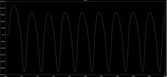

This is the output current in the load. It actually seems very reasonable. The current in R1 goes from +200 mA to -300 mA. I am a little confused as to why it doesn't show as symmetric. But since this is supposed to be a balanced output I do not suppose it would matter.

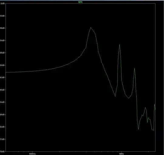

This an FFT of the current in R1. There are clear peaks at the first and second harmonic which a bandpass filter will need to remove. The third harmonic is down at -55 dB so I am not very concerned because this is smack in the middle of 160 meters. With poor antenna efficiency taken into account this would only bother other ham operators who were in my driveway.
I am confused because I expected the peak I was predicting to be at 472 kHz is instead at 450 kHz. At first I thought I had some sort of distortion going on. But I ran an FFT on the voltage of V1 (the sine wave). Instead of a 236 kHz peak I see 250 kHz peak in the FFT. Given that a voltage source is a pure sine wave in LTSpice I do not understand this. Is the problem with my circuit or is the FFT in LTSpice just buggy?
There is still more work to be done to make this a real thing, such as designing a circuit board. I am at this point trying to make sure I haven't made any large errors in this circuit or just plain made things more complex than needed. I've never build any transmitter before and I am mostly working from what parts are available to me.
Questions
  • Should I replace V4 with an LM317 ? This way I could tune the bias voltage on Q2 and Q4 with some degree of precision. Or should I just try and bias Q1 and Q5 instead?
  • R2 and R8 I think must have to be constructed from a 1000 ohm resistor in series with a 10K pot. Otherwise the variations in the BC337-40 would make the output lopsided I think. How do I determine if a potentiometer can pass a medium frequency signal?
  • My DAC will need to drive an op amp to create the signal used to modulate Q1 or Q5. What op-amp is appropriate for use at 472 kHz? Rail-to-rail design is preferred.

  • Thoughts, not answers to your questions. The FFT is hard to read, and I don't trust the first sharp peak. It looks like the FFT has limited frequency space resolution, and the actual peak is a bit higher in frequency. Second, you aren't worried about the third harmonic because of antenna efficiency. The antenna will probably be a better radiator of the third harmonic than the fundamental. It sounds like you need two matching networks - to the 50 ohm filter and then to the antenna. Perhaps use one and customize the filter as needed using a spectrum analyzer to tune? – cmm Jun 18 '18 at 20:03

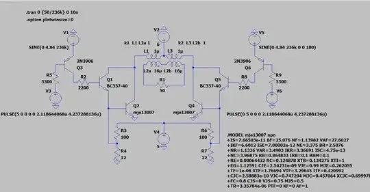

  • Looking again at the circuit, I notice that the polarity marking on the output toriod is reversed for one of the output transistors. To form an output which is symmetrical, one "dot" should be on the top and the other on the bottom -- the two sides should have opposite polarity. This may have affected the symmetrical simulated output you asked about. – cmm Aug 03 '18 at 16:33
  • Agreed, I will update the simluation and rerun – Eric Urban Aug 22 '18 at 01:45
I entered your circuit into LTSpice and made some test runs to verify the following:
In order to get reasonably accurate Fourier analysis, you need to simulate at least 20 cycles. I prefer 50. And, you need to add a SPICE statement setting plotwinsize=0 to eliminate data compression that compromises Fourier analysis.
The "polarity" of V6 needs to be PULSE(0 5 ...) rather than PULSE(5 0 ...) to match the 180 degree phase shift of V5 from V1.
I find that simulating a center-tapped transformer as two series-connected transformers produces more reliable results. There's no problem placing the 50$\Omega$ load across the transformer secondary in a balanced configuration, as shown below.

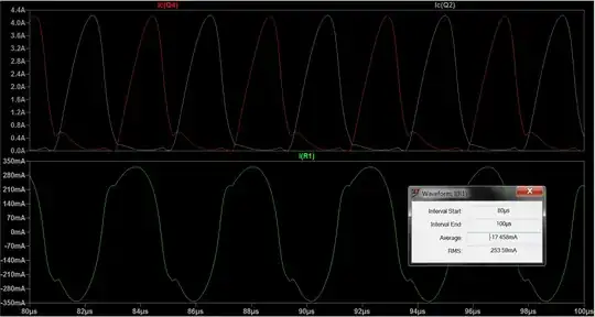

This circuit produces these currents:
And so the RMS output power is a bit more than 3W (with k=1 on the transformer).

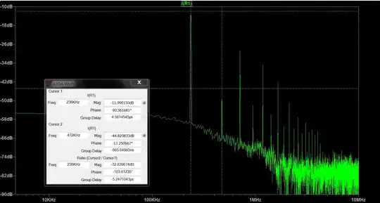

Note the sharp frequency spike at the 236kHz carrier frequency:
