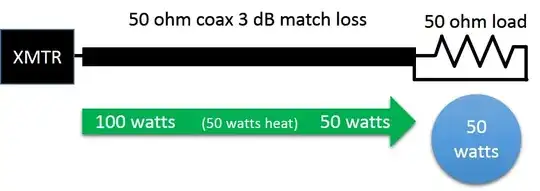

First consider a feedline that has a 3 dB matched loss connected to a 100 watt transmitter. We can convert dB loss to a percent loss:
$$\text{Percent Loss} = \frac {1} {10^{(L_{dB}/10)}}*100 \tag 1$$
where LdB is the loss in dB form.
This means that when the 3 dB matched line is terminated in its characteristic impedance, only 50% of the transmitted power (50 watts) will arrive at the antenna end of the line and be aborbed/radiated by the load. The other 50% has gone up as heat in the coax.
Figure 1

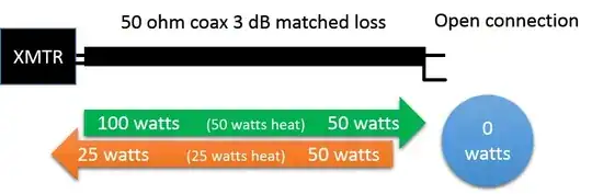

Now instead of a matched load, let's consider a most extreme case of leaving the far end of the coax cable open. In this condition, 100% of the power arriving at the open end is reflected back towards the transmitter. As before, only 50% of the transmitted power (50 watts) arrives at this open connection. This is now fully reflected back toward the transmitter. But just as the forward power was attenuated, so is the reflected power by the same percent. So only 25 watts arrives back at the transmitter.
We can now calculate the SWR at the transmitter:
$$\text{SWR}=\frac{1+\sqrt {P_r/P_f}}{1-\sqrt {P_r/P_f}} \tag 2$$
where Pr is the reflected power, Pf is the forward power.
The SWR at the transmitter is 3:1 in this example. Quite an amazing transformation of an infinite SWR at the far end of the feedline but it comes about as power dissipated in the coax.
