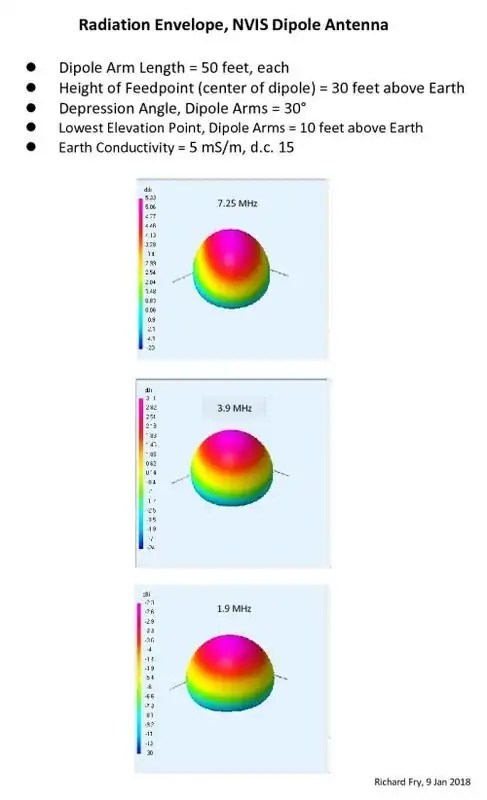

If the installation site permits, a dipole antenna in a vertical "Vee" configuration has radiation patterns suitable for NVIS applications -- and can have useful low-angle radiation, as well.
The graphic below shows its performance on the 40/80/160m bands for the conditions shown there.
Directivity ("gain") is highest in the 40m band, and feedpoint Z is more difficult to match to 50 ±j0 Ω on the lower bands.
