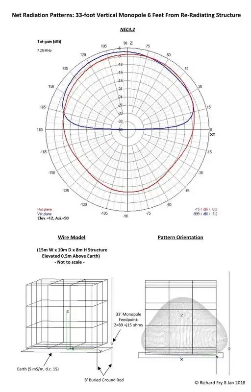

The NEC4.2 study/graphic first below shows how a structure comprised of conductors to (roughly) emulate the a-c power lines in a wood-frame house might affect the radiation patterns of a 40m-band vertical monopole located six feet away from one side of that house.
The effects of this may be different than those expected. enter image description here

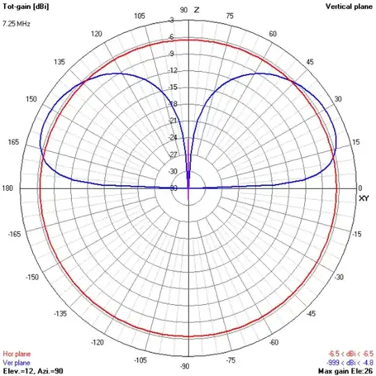

Below are the patterns for that monopole and its buried ground rod, by themselves (other things equal).

  • It would be nice to also see the pattern of the antenna without the "house", for the sake of comparison. – rclocher3 Feb 01 '18 at 17:44
    OK, I added them to the original post. – Richard Fry Feb 01 '18 at 18:53
  • So the "house" changes the best takeoff angle quite a bit, to be nearly vertical rather than 25° or 30°. I wouldn't have expected such a large effect, but perhaps that makes sense given that a lot of the RF is being absorbed and re-radiated. The azimuth pattern is distorted also, which is less of a surprise. Very interesting! – rclocher3 Feb 01 '18 at 19:26
